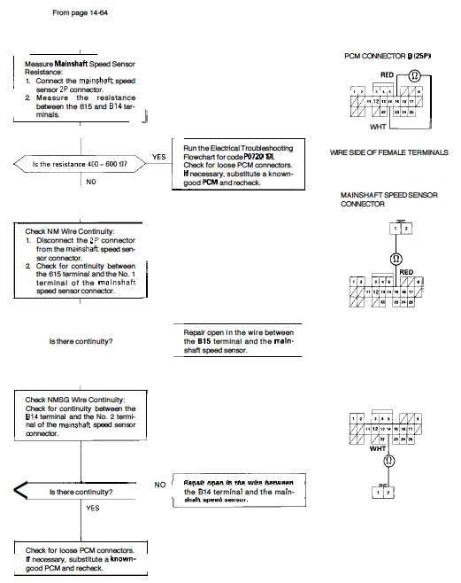

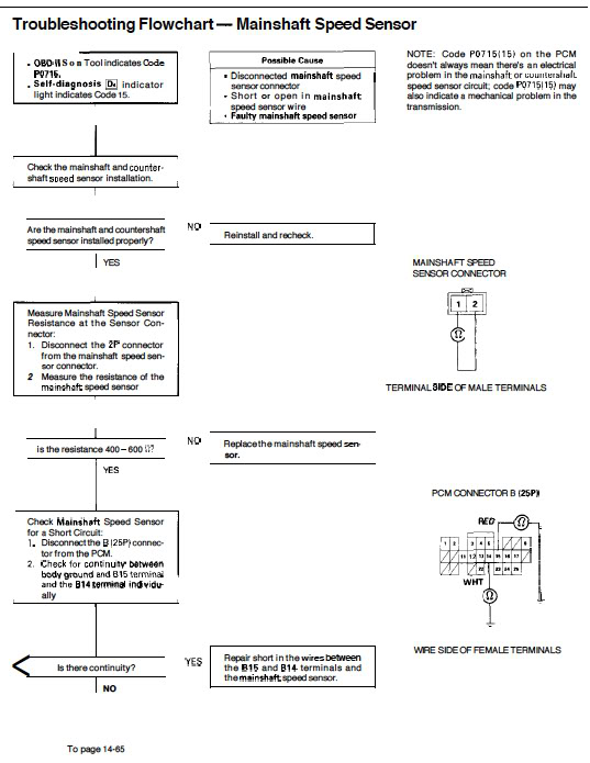

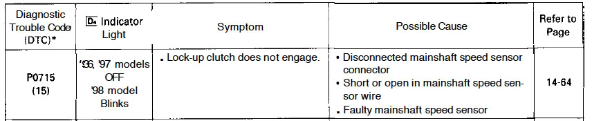

It's an automatic transmission trouble code. Here's what the manual says:

As per the troubleshotting chart posted it seems to be a problem with the mainshaft speed sensor and it seems to be covered by extended warranty.
So i will go to delaer and ask again if it can be fixed under warranty but I doubt so as they gave me wrong info earlier something realted to Linear Solnoid on trnasmission
