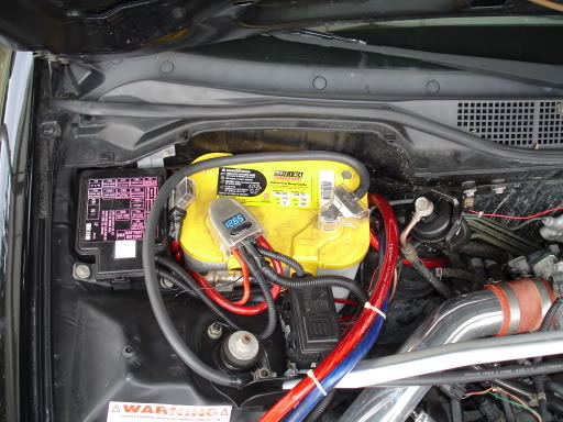

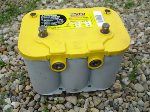

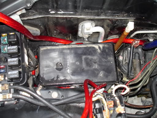

well not sure what year civic you have BUT i know for a 96-00 civic a yellow top D34/78 will fit in stock location with alittle modification... very minor 2 slices on the battery case, and flip over the plastic tray or something since the battery is larger than the battery case
i just flipped mine and havent had any problem.
the two small cuts on both sides of the battery is to clear the AC lines on the firewall and the front one is to clear the upper control arm bolt. very easy and battery is still sealed. i love this battery. my old one lasted about 5years even with repeatedly FULLY DRAINING THE BATTERY... old truck with alarm system parked for along time with it always using power.. i bought another one earilier this year.... when it went bad. still works great.

and yes i have reversed my battery terminals... the factory ground is on the outter passenger side. i only switched it because i didnt like the sticker on the battery upsidedown.
