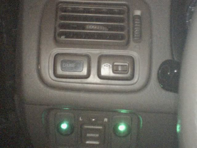

How do you get this section out, I'm trying to wire a LED into the vent but dunno how to get it off. I tried prying it, but i don't want to break it im not sure if it comes out that way. Help me out if you can.

its just held in by 2 clips. top and bottom. just get a flat head and hit the clip. it will pop right out.

To make sure you don't scratch your dash I would recommend putting some duct tape on the flat head or a thin shop towel. Also once you take it off make sure the little clips don't fall off the vent, because I lost one of mine and the vent comes loose sometimes, lol. If your having trouble prying it off just pry from the bottom, it shouldn't break, it pops out really easily.

Okay thanks guys. I know the other side popped out easy. Just when I tried this side it was tough so I wanted to make sure it wasn't fastened some way, so I wouldn't break it.
