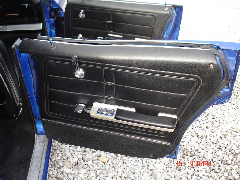

ya i know
i said i cannt hate on it because it does work since i did that on my 66impalas powe rdoor locks.LOL
http://i40.photobucket.com/albums/e2...6impala032.jpg
tho i did wrap my wires in black electrical tape so mine does blend in ALITTLE.LOL
you can see the black taped wires right above the sill plate afew inches up
ive had it hooked up like that for o hell.... 10years now... other than that one shorted wire when i first installed them i havent had any problems with the wires. only problem ive had is with my ghetto @ss button/switches i used for the power locks, and the alarm system remote controls stoped working properly.LOL
i said i cannt hate on it because it does work since i did that on my 66impalas powe rdoor locks.LOLhttp://i40.photobucket.com/albums/e2...6impala032.jpg
