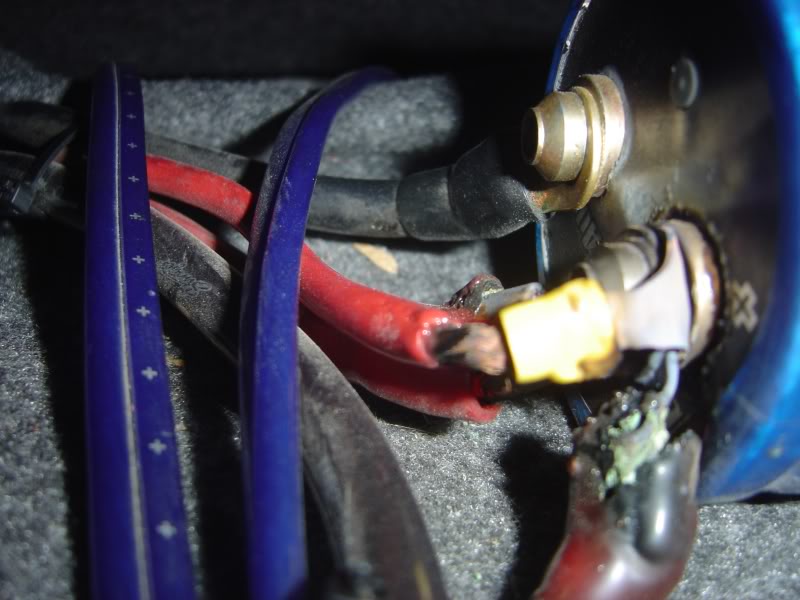

so ive had my cap now for about 5yrs and ive always kept it cause....umm i dont know i just have.Now my music is starting to cut out and i think the cap might be the problem...it looks like its going bad and the wires that are on one of the post like the plastic around it looks all brittle and kinda burnt...it just doesnt look right.So what all can i do to take the cap off and make everything right.I dont know what i would do with the wires that are on the cap now....like would i have to get a ditro block now or could i just splice them together or something???

Take a pic of your set up.
well first off.... check all your connections for a loose one.... even if the cap is bad it shouldnt hurt the system and make them cut out....
check your ground wires and tighten up those terminals on the cap and amplifier...
over time screws can get loose... make sure they are all good and tight rust/corosion free conetions...
and if the problem is still thier... just remove the cap
simply unscrew the positive conection and tape up that wire like a **** and same to the ground and just slap em to the side.... OR if your using that cap as a distrro block then with a TWO bolt and nuts simply bolt the 2 wires together for each terminal. and again use electrical tape all over them like a ****.... and just slap em to the side.... ya realy only have to tape up the power wire but for consistency i always do both
and if the problem still is thier then its not the cap...

o DAM..... ya id say your cap is bad...... its GOTTA BE leaking to corode and melt the wiring like that!!!!!
you might even have to run some larger wires... cause most wires shouldnt melt like that unless ya have a short or pulling WAY to much power thru that smaller wire!
HOW MUCH POWER YA GOT PUSHEN FROM YOUR AMPS? and what size wire is that?
id say ya defintly need to upgrade your wires!
tho that cap definatly has to be leaking to corode the wires like that.....
