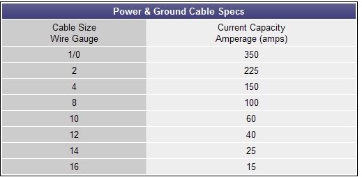

I found this...don't know if it helps or not.
Here's the link to the site.
http://www.the12volt.com/info/recwirsz.asp
