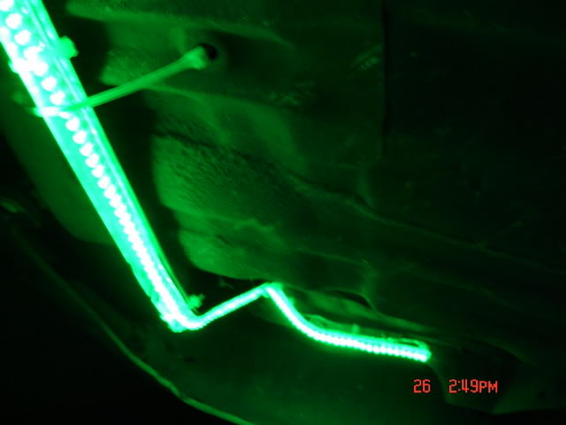

leds are a much better choice and can be bent
led flexstrips RULE ALL OTHER!!!
and come in 6ft lengths
http://www.oznium.com/led-flex-strips
led flexstrips RULE ALL OTHER!!!and come in 6ft lengths

now im all about flexable led strips from oznium... water proof and can twist into any shape for a true corner to corner UB lighting. ill finish the UB lighting sometime next month......

i also wanna get some of those led strips for my wheel wells, will they work for that?
