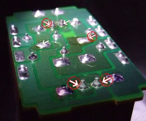

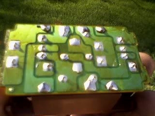

take your main fuel relay out its under your dash and resolder then cracked spots on the circuit board. its a common thing.
