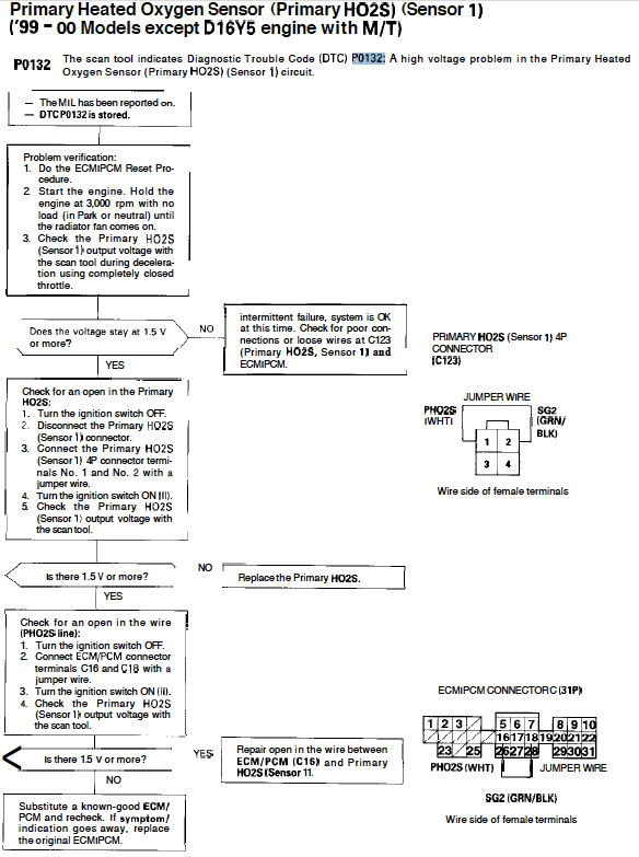

P0132 indicates a fault in the primary O2 sensor circuit. This sensor is instrumental in ensuring that the engine is using the optimal air/fuel ratio. The failure of this sensor is a common cause of low gas mileage.
My guess is that in the past your sensor/circuit was intermittently faulty or partially operative but now it has completely failed. If you seriously want to solve your mileage problem, the first step (and possibly last step) is to fix the O2 sensor or its circuit.
