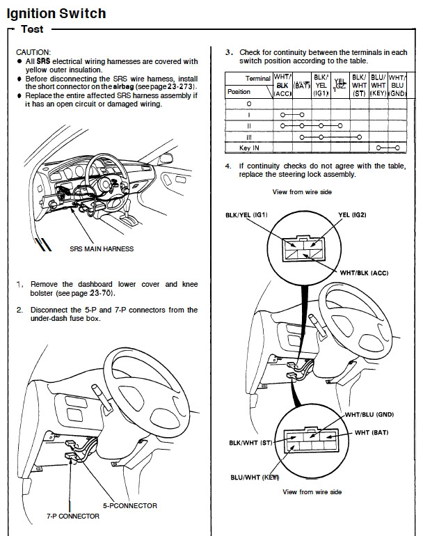

You have two problems. A short in the VSS circuit and a bad ignition switch.

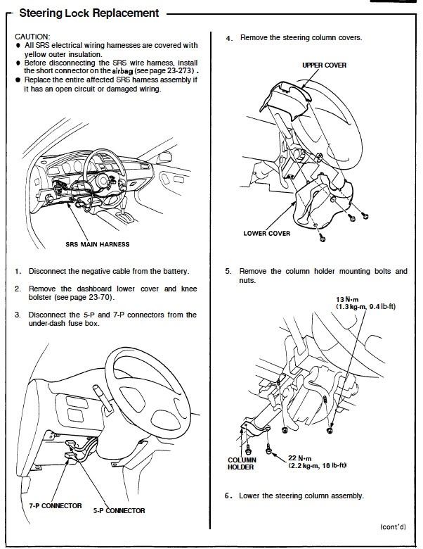

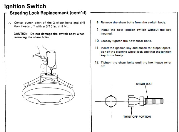

Here's how to test and, if necessary, fix the ignition switch:

Also kind of confused with how to check continuity between the terminals. Could the problem be caused by something other than the ignition switch, or if I switch it will it likely solve that problem?
I'll check for shorts in the VSS wire and check the connector tomorrow. Is the ignition switch causing the starter to keep spinning?
