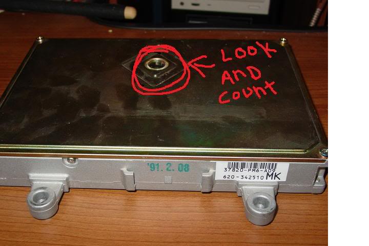

how do i pull a code on my 91

no they wont..... its obd0 (91 civic) they only can do 96 and up.
also where you at in tenn.
turn your key on pull your passenger carpet up and you will see the ecu in the center of it is a blinking light count the blinks, each fast blink is 1 and each delayed blink is 10, it may show more than one code, also it will repeat, so recount them until you are sure you know what the code(s) are. then tell me the number you got and ill tell you whats wrong.
