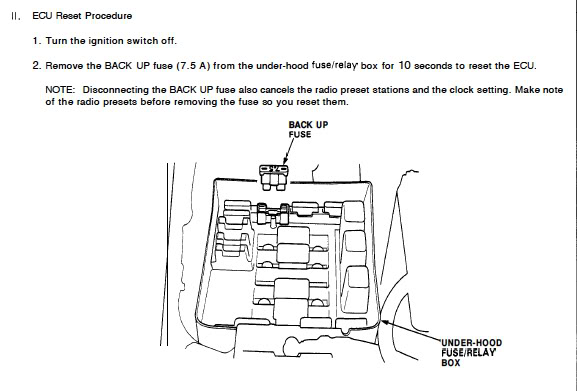

Old Aug 8, 2008 | 09:05 PM
Start by resetting the ECU. Then run the engine/drive the car to see if the CEL turns ON again. Post codes that repeat.

Alright, I pulled the fuse and started it up and the CEL came right on, let it run for a couple of minutes.
Pulled the codes and it's a:
41-Primary Oxygen Sensor Heater
But why would that make it run rich and a little rough?
