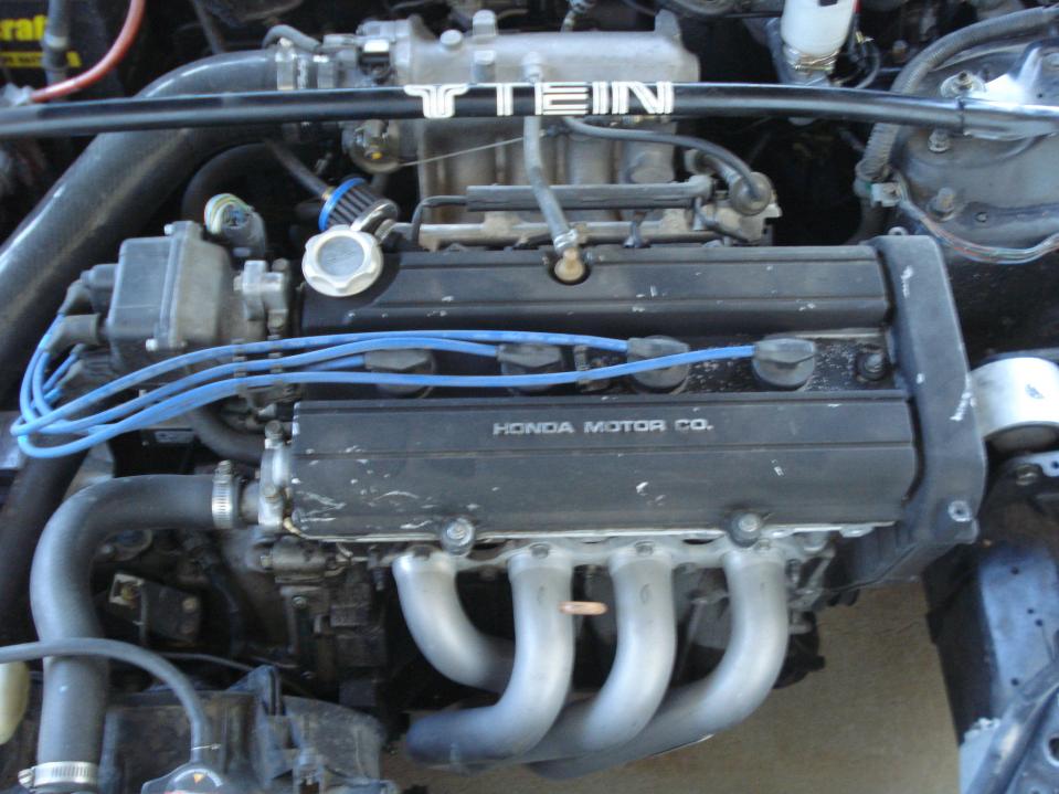

there is a pic of the motor
the receipt i got for the motor say's it's a 96'-97' japan spec B18B long block
if you could direct me to a site that would have this right ecu and anything else i would need to change out the old ecu for a new one that would be great
(oh and it doesn't say anything bout being vtec, and I do beleive ur right maybe it's not a gsr, thank's for helping me out on this)

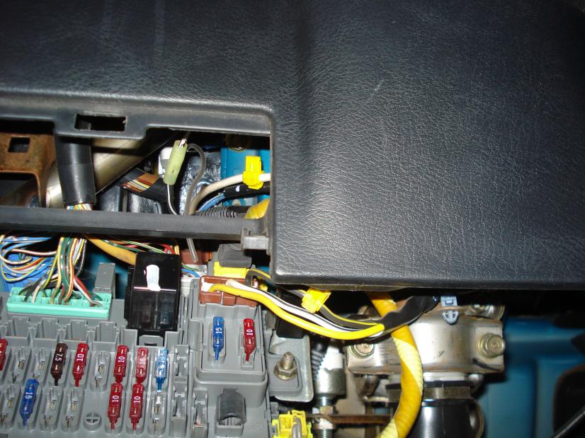

Old Apr 28, 2009 | 07:33 PM
Is the engine and car wired for OBD1, or OBD2a?
Old Apr 28, 2009 | 08:01 PM
zack94gsr's Avatar
Joined: Apr 2009
Posts: 6
From: white sands, new mexico

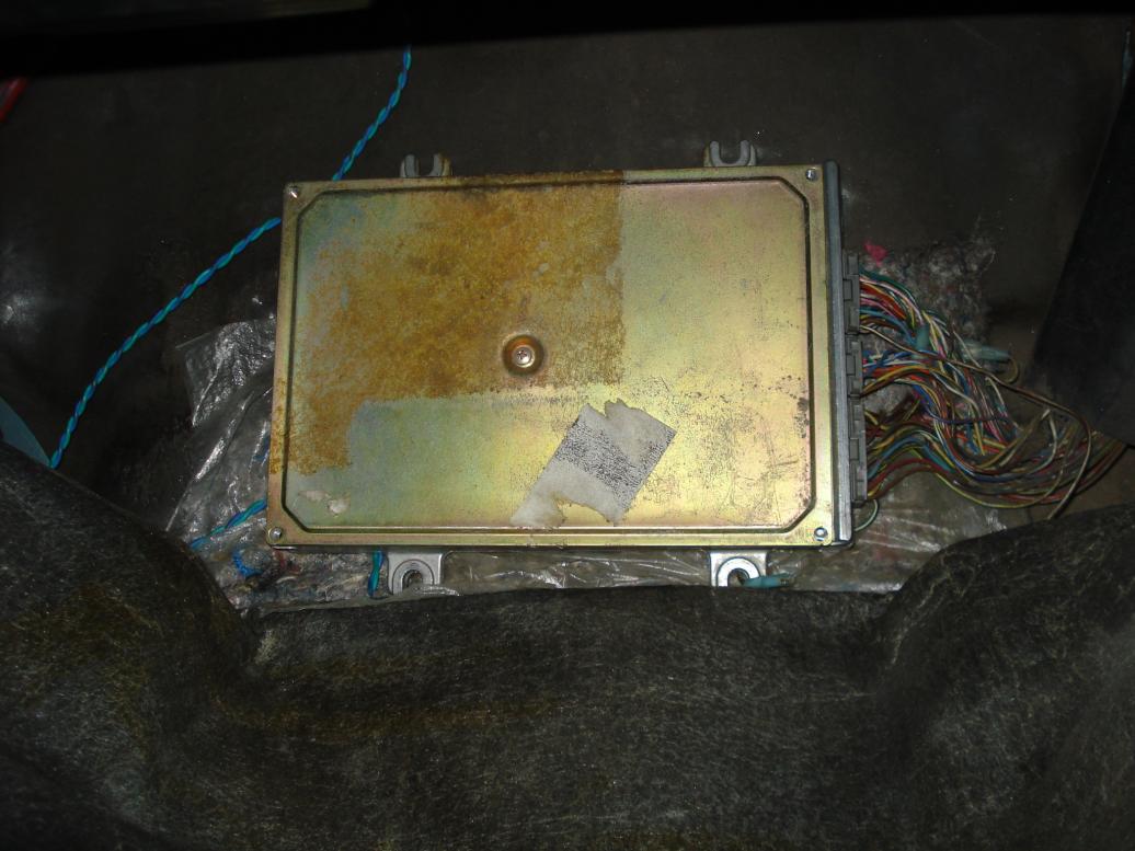

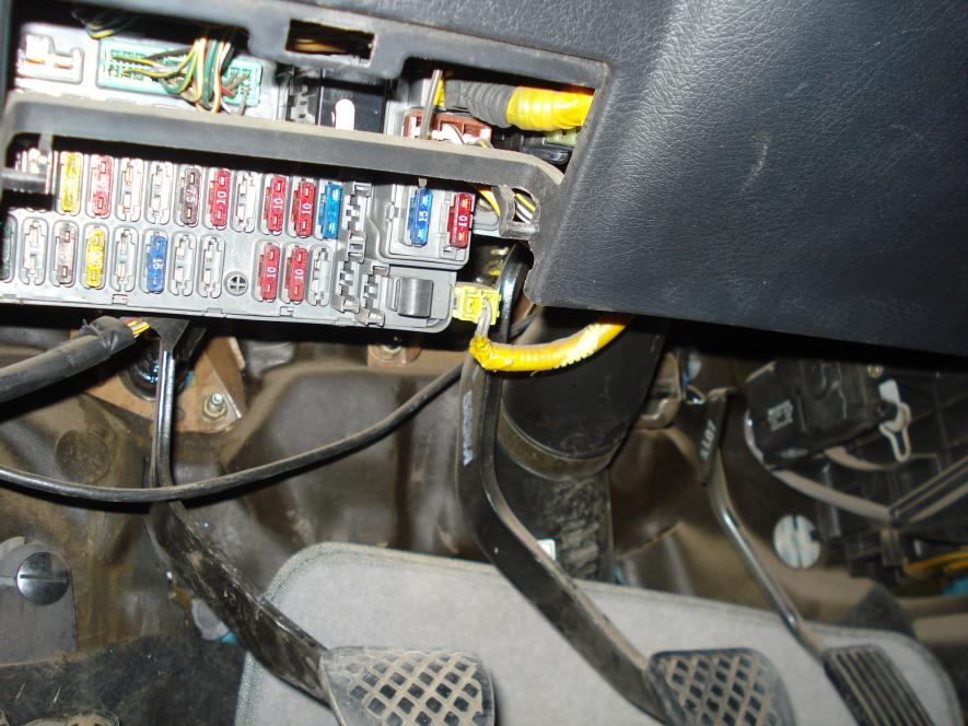

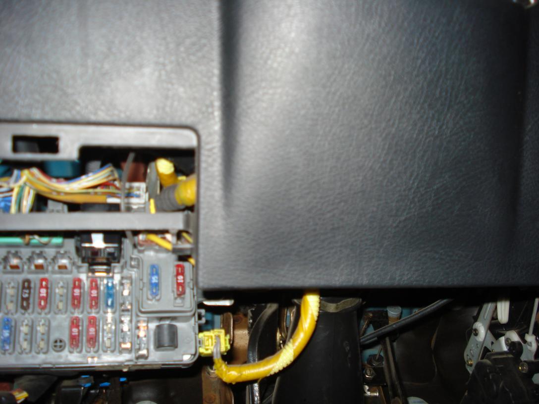

from what i can tell there is no hook up under the steering column for an obd2 and on the front passenger side under the carpet there is a small rectangular box that has wires running from it.hopefully you can get something from these pic's
here our the pic's
Attached Thumbnails need the right ecu?!-dsc00411.jpg   need the right ecu?!-dsc00412.jpg   need the right ecu?!-dsc00413.jpg   need the right ecu?!-dsc00414.jpg
Old Apr 28, 2009 | 08:05 PM
It's OBD1.
needs a P75 ECU.
Check forums, ebay, and junkyards.
Keep in mind that it is transmission specific, you have to get one for the transmission you have (auto or manual).
