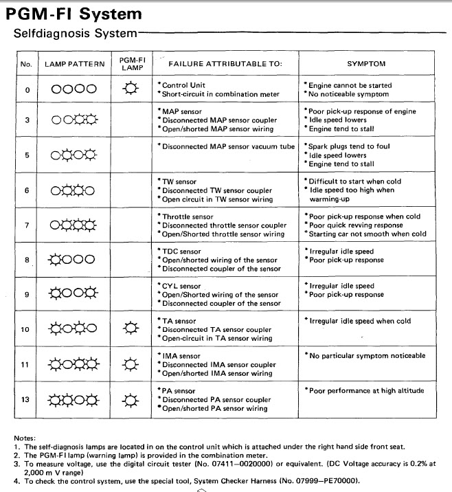

It's the CEL indicating a fault with one of the sensors. Here's how to read the code from the ECU:
