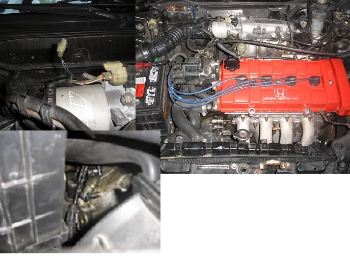

can you get a pic of the under hood? and do you know what ecu your running?
Powermidget 02-22-2007 10:59 AM
RE: OBD0 to OBD1 Conversion
ill check to see what ecu im running and ill get an engine bay pic up later today
Powermidget 02-25-2007 11:30 AM
1 Attachment(s)
">Attachment 37281This is the engine bay and the two plugs that have no connection (throttle body and distributor)
finalimpact 02-25-2007 10:24 PM
the un[lugged plug in the tb pic is for a purge solenoid...dont worry about that, it wont throw a code or hurt you. it looks to me that the engine is running obd1. it also looks that your second empty connector should be for your o2 sensor(1 wire)...........
