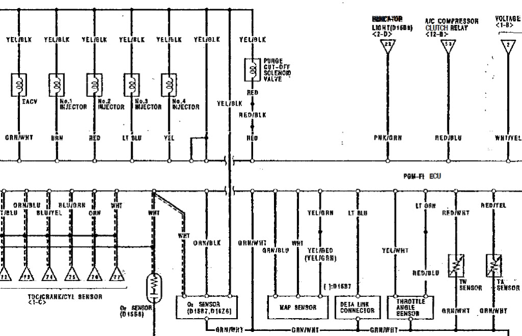

It may be possible to switch the TPS, IACV, and IAT 2P-connectors:
