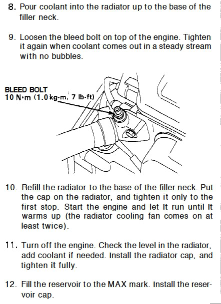

Did you bleed the cooling system?
Old May 4, 2009 | 06:26 AM
pjku79's Avatar
Joined: Mar 2009
Posts: 18
No I did not bleed the system. I just let it run for a little and kept filling it. How do you bleed the system?
Old May 4, 2009 | 10:57 AM
Does a B18 engine have a bleed bolt for the cooling system? It's usually located where the upper radiator hose attaches to engine.

I dont know if I have a bleed bolt. I will check tonight. If I have one how do I properly use it. Do I just open it up and close it when fluid starts coming out? Does it need to be running?

Bleeding:
1) Push the heater lever to MAX heat and then do these steps:
