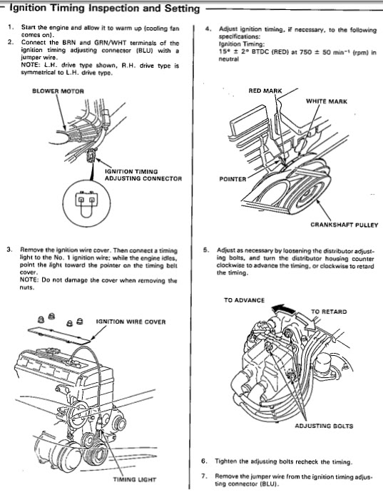

its a 89 honda civic si
Old Aug 11, 2008 | 03:47 PM
Pretty much the same. This is for the 90 Civic Si:

where are the brown, green/white wires i cant find them
Old Aug 13, 2008 | 11:27 AM
under the passenger side of the dash.
