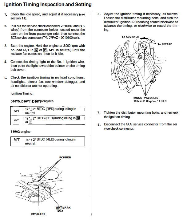

Awesome links! Wouldn't happen to have one of those for ignition timing would you? The marks on the crank pulley got me kinda puzzled. The one that's off to the right by itself i'm guessing is the tdc mark then i'm not sure as to what the three to the left of it are...looks something like this ||| |
Old Apr 1, 2010 | 08:43 PM
Use the middle red mark in the group of three to set the ignition timing. The lone white mark is for setting the mechanical timing.

Thanks man...just one more question...is it necessary to do anything with the scs connector? Does that act as an electronic advance or anything? Or can i leave it plugged up when i set base timing?
Old Apr 1, 2010 | 09:22 PM
You must jump the connector to prevent the ECU from controlling the timing while you set it.
