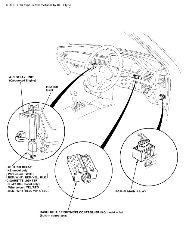

Here is a picture of the relay that is clicking... it is located on the drivers side under the dash just behind the door hinge. Is this the main relay?

The diagram below shows the location of the main relay. Yours is located equivalently on the left side.
Retrieving code 16 would verify a main relay problem.
