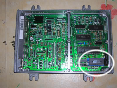

If I had to guess, I'd say that car has almost definitely been boosted, then blew a motor, then had a y7 swapped in.
Check out the ECU, figure out which one you have. Also, crack it open and see if its been chipped. If it has, it will look like this..
If you see that chip, I would get into contact with the seller and figure out who/where it was tuned.
