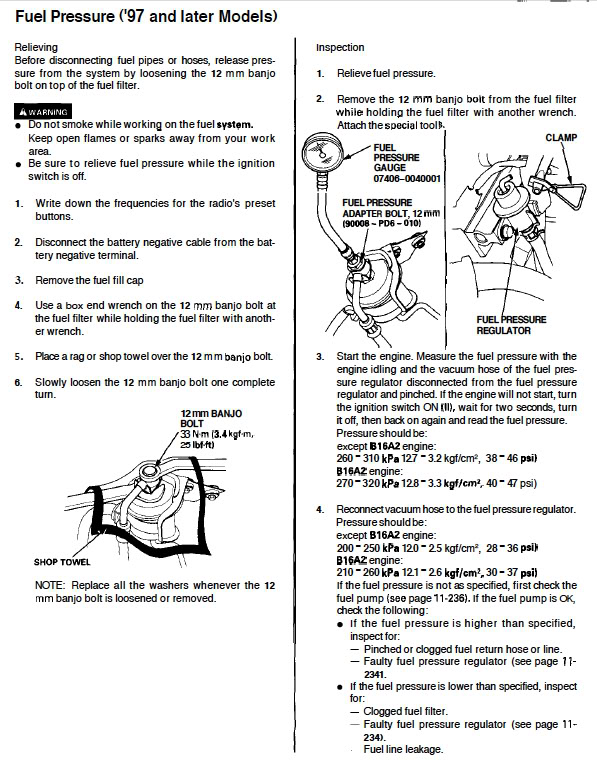

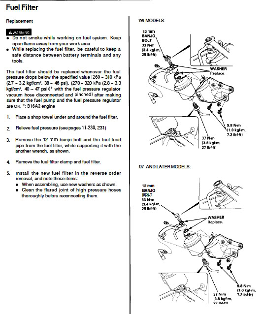

Install only the basic OEM NGK plugs recommended in the Owner's Manual.
Torque the plugs to 14 lb/ft after coating the threads with anti-seize grease.

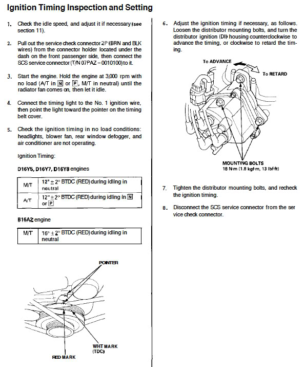

Thanks for the reply Ron. I do not have the jumper plug referenced in your writeup, so I will probably skip the timing adjustment and do everything else. Which NGK plugs are the originals? The cheapy V-series, the G-series, Iridium or Laser Platinum? As far as wires go, the dealers near me are all closed tomorrow when I go to do this work...are the Autolite professional series wires any good? What about a breather filter...is this car equipped with one? Also, should the car be cold, warm, or hot when I take the plugs out? Any tips will be appreciated.

The special tool mentioned is not anything elaborate that you must have. Instead you can just use a paper clip, piece of wire, etc. to jumper the plug. It is only necessary to short the two pins together. You will know you have a good connection when you start the engine (step 3) the check engine light should come on steady because the jumper is in place.
