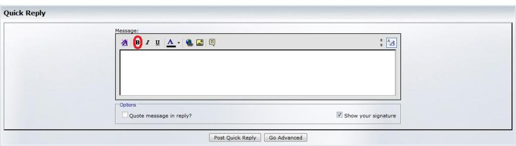

This button right hurr:
*edit: actually, it might depend on your account settings. Lemme check into it.

Old May 28, 2010 | 12:04 PM
Try it now. The buttons should show up now; it's a setting in your profile that you turned off when you joined.
