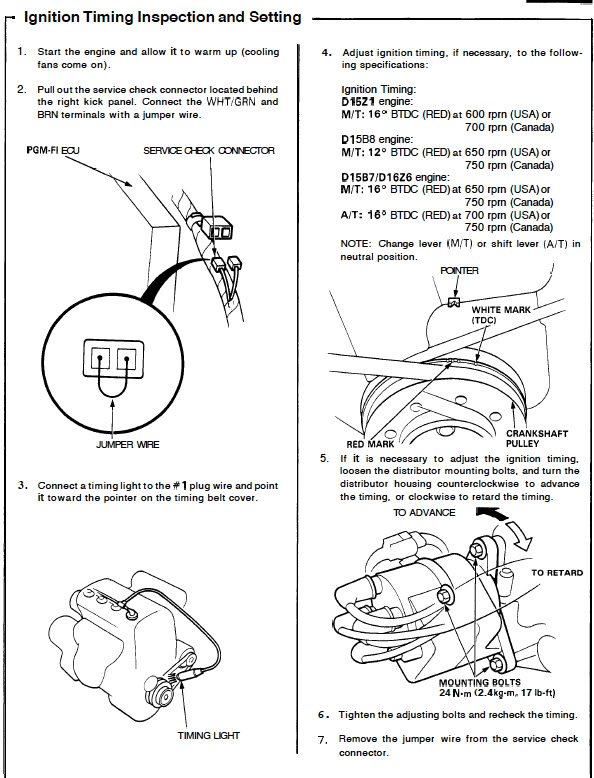

The ECU is reset by removing the under-hood BACKUP fuse for a minute or so.
To set the ignition timing, did you jump the service connector? Did the pointer align with the red mark (middle in group of three) on the crank pulley?

To set the timing correctly, the engine must be warm and idling to spec and the service connector must be jumped.

Considering the current running problem, you want to follow the procedure by the book to know for sure whether the timing is off or okay.
While the service connector is jumped, note also whether the CEL blinks out a code.

Setting the timing without the connector jumped will make it way wrong.
In normal run mode (connector not jumped), the ECU varies the timing all over the place to stabilize the idle. It will always be quite a bit advanced from the 10 degree mark. You may not even see the marks with the connector not jumped and the timing set properly.

I really don't understand your resistance to check the ignition timing using the proper procedure detailed in the factory service manual. It's so easy. Warm the engine up, make sure the engine idle speed is to spec, turn the car OFF, jump the service connector, hook up the timing light, turn the car back ON, and read ignition timing. So simple. During this procedure, you will also know whether the ECU is throwing any CEL codes. When finished, you can say confidently that the ignition timing is OFF or set to spec and also possibly recover a useful CEL code(s). This will move you closer to finding a fix.
