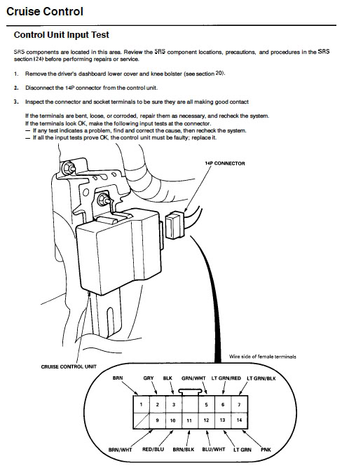

For a Civic, I would suggest you perform the Control Unit input test (see manual for specific tests):

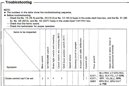

Old Jun 30, 2008 | 11:17 PM
Default RE: cruise control
So I got bored tonight and did some searching. I stumbled across someone mentioning something about the clutch switch. My brake light switch bumper thing broke recently and I fixed it, so I decided to go look. Sure enough, I go outside and look, and come to find out that the bumper thing was gone. I put a nut and bolt in its place, just like I did for my brake light, and then I took it for a drive. The cruise control works!
