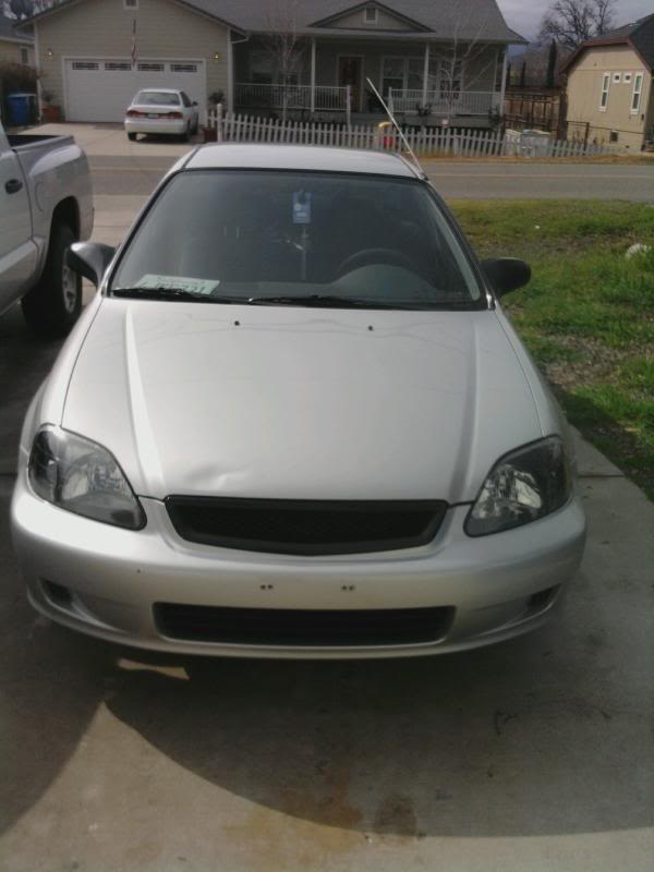

I have a pretty ugly dent in my hood.. its sort of small.. about the size of my fist.. but its right in the front of my car so i want to get rid of it.
Here's a pic of it:

I guess the first week the original owner had this car(back in 2000 when it was BRAND new) he was parked in a parking lot and a jeep backed into the space infront of him. the tire on the back of the jeep hit the hood of my car. thats how i got my dent.
Its pretty cool that the paint isnt cracked or anything.. so if i can just figure out how to pop it out, i'll be good to go.

I don't know that paintless dent repair can fix that one. It's in a tough spot. You could try the old temperature change trick. Requires a hot hood (hair dryer, carefully applied heat gun, or other form of heating the hood) and some canned air (turned upside down so the liquid cold stuff sprays). The resulting sudden coldness causes the metal to contract, POSSIBLY making the dent pop itself out.

the guy i bought it from said that his mechanic told him it could be popped out, but it would require drilling a hole or two in the layer of metal beneath it(because the hood is two layers, i think..) and pushing something up on it to pop it out.

just heat it up with a hair dryer for a few minutes untill its nice and hot and then hold canned air upside down and spray it on there till it ices over.. it will pop out.. when you hold the canned air upside down, it releases co2 that is like -30 degrees or something like that... so it will expand and contract..
(warning: Heat guns are ok to use but dont use them too long or hold them too close cause it can f with your paint.. Source: GoOgLeS!)

crazy stuff. i watched a few with the hair dryer too..
some work.. some dont.
the big dents tend to pop out easily.. the small ones usually dont pop out.
i'm afraid that mine might not.. but i'm still gonna give it a shot. for like.. 15-20 bucks i can pick up a can of air and a cheap hair dryer.. or i can just have my girlfriend bring hers over. lol.
