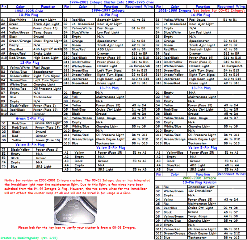

the problem is this. if you splice into the wrong wires, you will have a problem like so.
You will wire the lights into the fusebox where fuse 19 is. ground the power to the body and your good to go. never splice into the harness without knowing which wire your cutting.
Disreguard the integra slusters to the right, this is just for the wiring on the g bodies.
