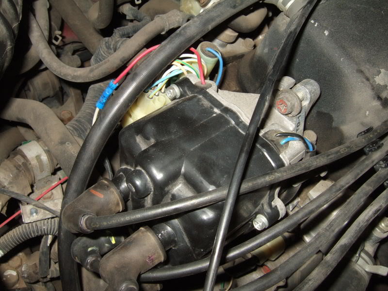

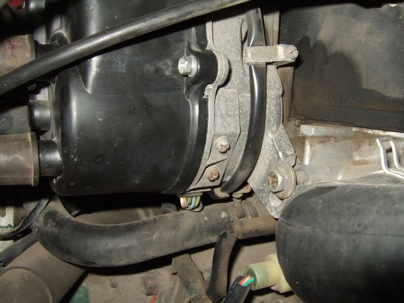

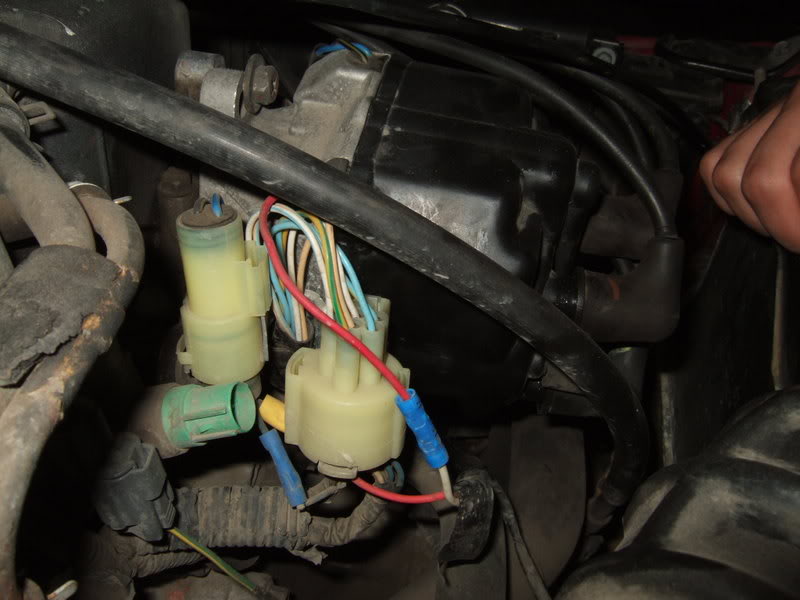

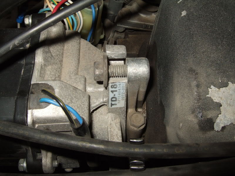

We started poking around the motor a little and found this.

Seeing how they had to cut the mounting brackets , im going to assume thats not the factory distributor. CAN SOMEONE TELL ME WHAT IT IS OFF OF? (from the numbers on the tag?). It runs good so i wont touch it, i just kinda want an explanation for this hack job. Has anyone ever see this done before?

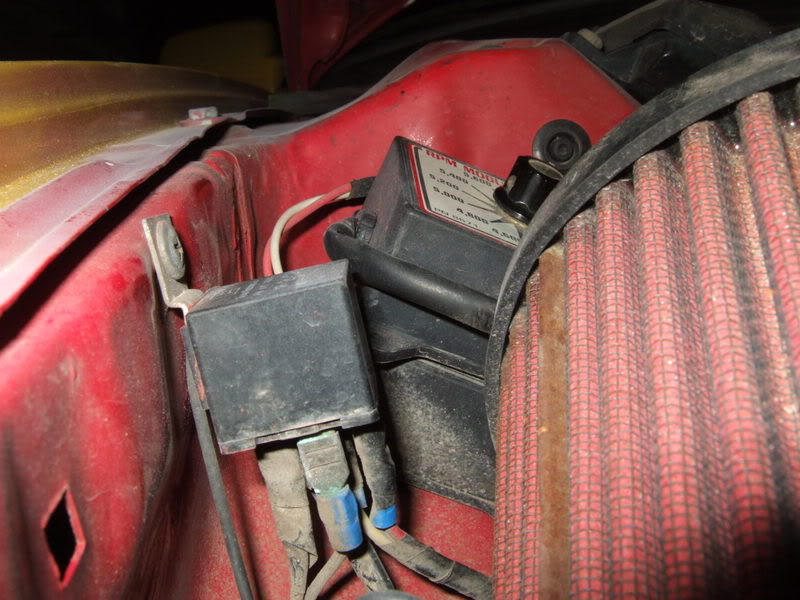

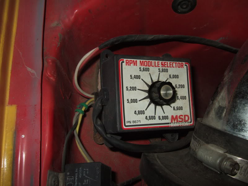

This is also hooked up to the distributor.

When we were looking at it at the salvage yard we thought "Rev Limiter". Nope, doesnt affect that. What is it , and what does it do? We never really had the chance to play around with it. We set it at 6800 and just drove it like that at the track.

the msd box, is it affecting ignition timing?
hmm, i think i spy an unplugged vtec solenoid... (the little green plug next to the distrubutor) but it seems the other vtec wireharness going to the ecu (green with yellow stripe wire) is still plugged in. I'm not exactly what the function of the unplugged harness is.
EDIT: i looked it up, the unplugged harness is the oil pressure switch.

I'm pretty sure the msd box IS a "rev limiter" of sorts, or it is at least to turn something on or off at a certain rpm. My guess is that whoever had it thought it would allow them to change the stock rev limit, but without messing with the ECU it didn't actually change the rev limit of the engine
Old Aug 4, 2008 | 12:20 AM
looked its model number up, it's the rpm selector for a shift light or any other MSD rpm related accessory, including rev limiters
on the last page of this link (.pdf file) you will find the model number as the rpm selector module for any MSD rpm related accessory, including rev limiters and shift lights, tachs with shift lights, etc.
my guess is that the one you have is currently wired for a shift light since when you mess with it the switch it doesn't do anything.
http://www.msdignition.com/pdf/8952_frm23756%20.pdf
here is one for sale and it has a description
http://store.summitracing.com/partde...5&autoview=sku
does your distributor have an external coil?

no external coil

Easy way to find out if its the stock motor look to the left of the exhaust manifold. There will be a letter followed by numbers. Could be something like this D16 followed by sommore ****. Tell us what those say and we'll help you out.
Old Aug 5, 2008 | 09:17 PM
he was asking if the distributor was stock.
Old Aug 5, 2008 | 09:21 PM
jpnolan's Avatar
Posts: 1,833
From: Miami, Florida
ya but if we want to help him know what to do on his car it might help to know what motor he has.
Old Aug 5, 2008 | 09:31 PM
oh yea, that's true.
i'm concerned about his unplugged oil pressure switch. i remember that i forgot to plug that back in on my car at first after i replaced my VTEC solenoid gasket. The CEL came on.
With that unplugged, you should be throwing a CEL.
Old Aug 6, 2008 | 09:57 AM
raboyto2's Avatar
Joined: Aug 2008
Posts: 11
no check engine light.
