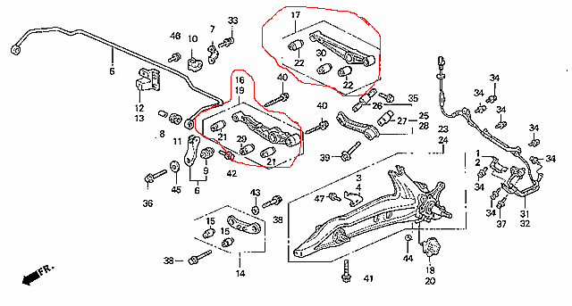

so i plan on lowering my car soon, but before that i wanted to get LCA. ive convinced myself to get OEM ones because i dont like the bling factor, and alot of negative comments about aftermarket ones and also their price. So i went to majestic honda and found this display
the top one circled (#17) is described as (ARM, R. RR. (LOWER) and has quantity of 2 priced at $191.86)
the bottom one circled (#16/19) is described as (ARM, R. RR. (LOWER) and has a quantity of 1 priced at $70.53). and (ARM, L. RR. (LOWER) and has a quantity of 1 priced at $70.53) respectively.
i know i need L and R LCA but confused on what the difference between 17 and 16/19 are.
thanks
thanks

The difference is that it looks like 16/19 are the OEM LCAs that have ABS mounting points and rear sway bar endlink bolt holes.

wouldnt that mean they would cost more? since the other ones dont have abs mounting holes and rear sway bar endlink bolt holes?

What Civic year and model in the Honda catalog were you looking at to find this diagram?
And what part numbers are listed?

i was looking at 92 honda civic lx rear lower control arms. and i was using the majestic honda website.
part number for:
16 was 52350-SH3-A12
19 was 52360-SH3-A12
17 was 52350-SR0-A10
part number for:

Well part 17 is actually $195 each. To confirm this, try adding 2 of them to your cart and looking in your cart.
And I just compared 16/19 to the ones for my car, by looking up my part numbers for my del Sol, and the part numbers were the same. So this means that 16 and 19 are not ABS/sway bar compatible... they are actually the same ones in my FS thread (not telling you to buy them from me, just giving you a visual... if you want to see parts 16 and 19 in a real picture just look in my FS thread)

yea i figured they was $195 each. and is this because they are the abs/sway bar compatible? i really doubt i will ever get a sway bar, so im just curious if thats the difference.
Nah, part 17 is definitely not sway bar compatible. I don't know why they are so expensive.
Look at LCAs for a 95 Civic EX. Those should be sway bar compatible. I would buy those (might as well... then if you want sway bar ever in the future you already have the LCAs), they're only $71 each.

alright cool. so why the heck is the price so different for 17 and 16/19? maybe different bushings or metal? idk
I am very curious myself about this.
