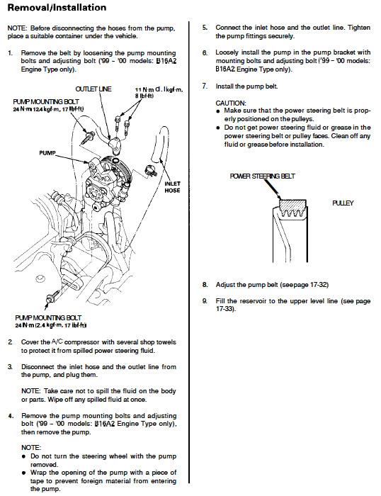

Hello, Trying to takle replacing power steering pump my self. Purchased used one. Would appreciate if any one had any suguestions. Or any special steps needed to be done to acoplish task. Help is appreciated.
Old Sep 20, 2008 | 08:32 PM
