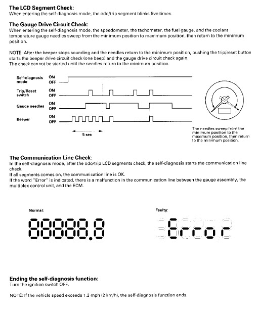

RonJ, great diagram! Thank you! I will have to print that out and try it. I honestly had no clue there was such a thing you could do.
