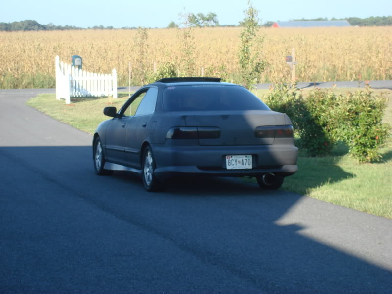

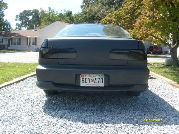

hope this helps you, heres a pic of mine

that pic was right after I installed them, its been 6 - 8 months since I tinted them and they dont shine like that anymore so later you might want to clear them.

got an updated pic handy of what they look like now?
