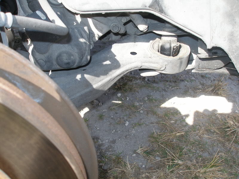

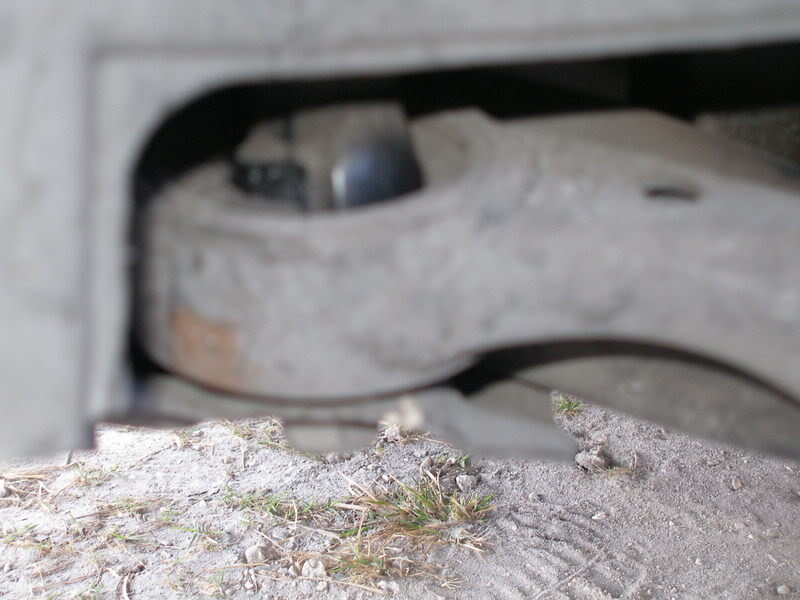

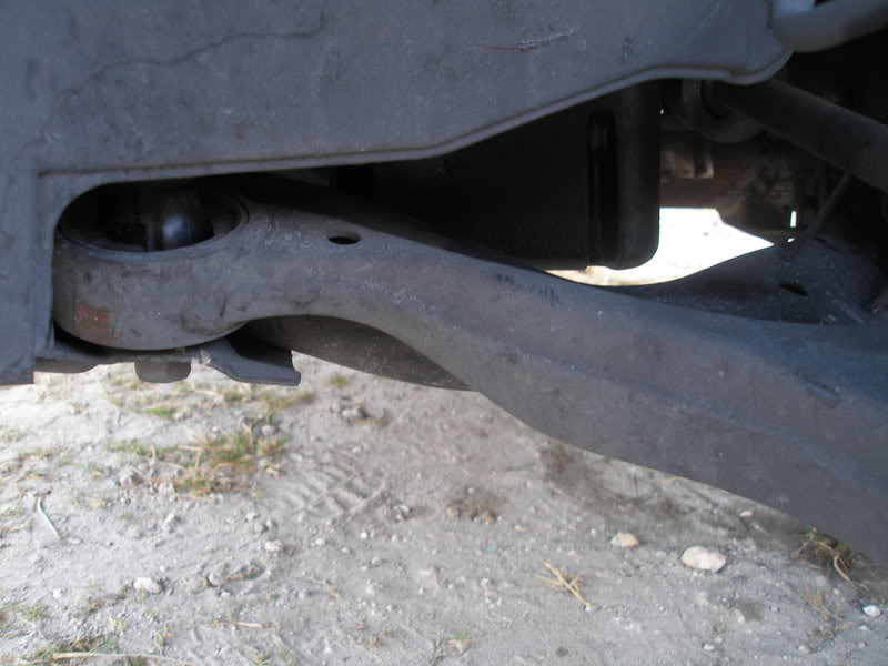

Ok heres pictures of what Honda was showing me, that i just took. If you know anything that can help me that would be great. BTW i checked the struts by pushing down like bakertime said, on each corner and the car came back up quick and no bouncing at all so i guess there fine.
Here are the pics on the LCA from both side on the front tires.
Yeah, that bushing is toast. I wouldn't drive that car until that's fixed if I were you. I believe that's referred to as the compliance bushing, and that's a normal thing to wear out over time. When I had my 01 Civic I had to replace it about a year and a half ago.
Replace with an OEM bushing, none of that Polyurethane stuff. Those can't rotate on multiple axes, so you are left with a very altered suspension geometry that can reacte unpredictably and cause damage! You might want to have a shop do the work, although you could probably remove the arms yourself and save on some labor. Any auto shop should be willing to press the old ones out and the new ones in for you.
Sounds like your struts are fine also, unless you can see some fluid leaking out of them!

Yeah - baker has a good point. Polyurethane bushings are WORTHLESS for a DD. They don't last as long as stock, and make for a bouncy ride. IMO they should only be used for track.
Getting that from Honda will probably be like 50 - 80 bucks...somewhere in that ballpark.
If you go ahead and pull the arm off yourself - you can take it to a shop and have them pull and press in the new one for you. They shouldn't charge you more than 20 bucks.

Ok well i took the car today to a shop and get quoted for $200 labor with me buying the parts, they said they needed to take out the arm to press the new ones in. Is it difficult to take out the arm and save some $$$ by taking it out myself....

Well just thought i let everyone know i was finally able to get the control arms off today after trying for a month. Took them to New Jersey Auto Parts (BUMPER TO BUMPER) and they charged me $20 to press in the Compliance Bushings like you guys said they would and put them back in. Now just gotta wait and see if i hear the noise when i drive around town.
Thanks for everyone's help.
Yup a quick update for any future readers with a similar problem. It's been 11 days now and the sound it completely gone. I feel so relieved that i don't hear it anymore and takes my worries away. So when in doubt check your compliance bushings. Very inexpensive parts and labor if you buy the parts and DIY. Spent no more than $60 for parts and pressings. Would have spent $40 if i bought the bushings online and not at my local dealer. Oh well you learn from your mistakes.
