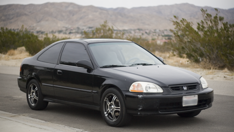

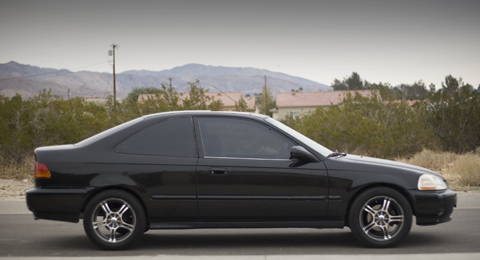

I have a 1997 honda civic and it has some really messed up wheels on it there to big well the tires are. They are 16's and tire size is 205-55-16
is there anything i can do to fix this? get new tires? smaller wheels?

Well if u like those wheels and want to keep them, just buy new tires at the right size. You need 205/45r15 size tires.
http://www.tirerack.com/tires/TireSe...sortCode=44850
if u want the car lower, get some new shocks and lowering springs or coilovers.

because they just look super ugly
i bought the car with these one but im having difficulty on picking some buttery wheels
