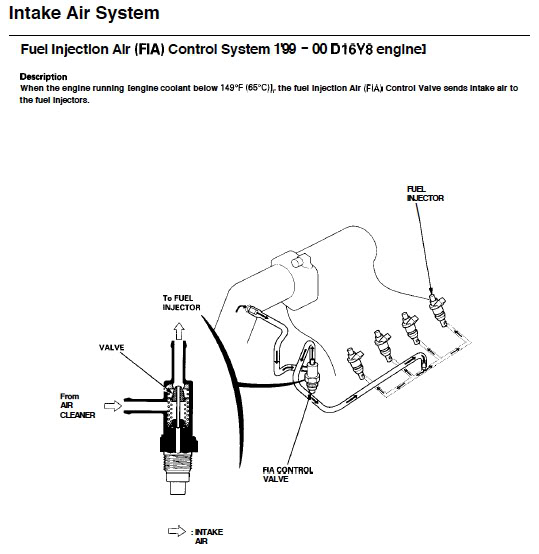

Originally Posted by Forty04
I found out the hard way, during my motor swap, that 96-98 IMs are NOT the same as 99-00. They appear to be in almost every aspect, but they ARE different.
The 99-00 Manifolds have an extra air injection system built into them, with these tiny little ports that WILL leak air and cause ridiculous idle surge if you try to attach it to anything other than an OBD2b head.
For anyone interested, it's called the fuel injection air control system, and it's unique to intake manifolds on 99-00 D16Y8 engines.

Hobo, you'll be fine with a 96-98 IM. If you find a 99-00 you're just going to have to weld up those damn air holes. Stupid fuel injection air control system
