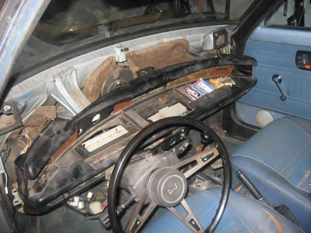

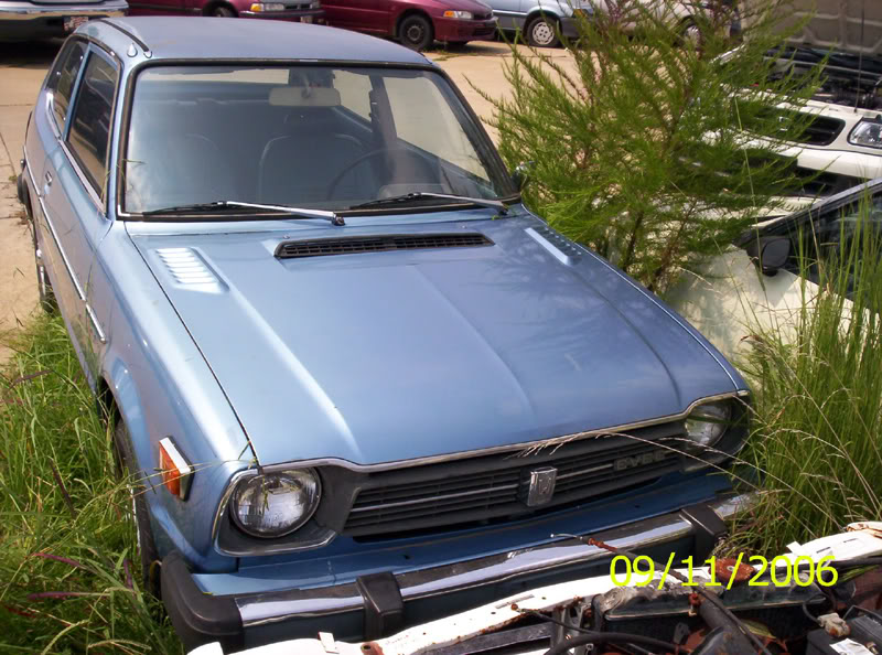

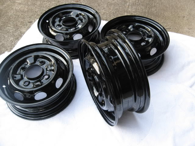

Here goes: I bought the car in September of 2006: Attachment 19342 Attachment 19343 Attachment 19344 Attachment 19345 I did a quick modification of the suspension and set it down a few inches and then a week later, the engine blew: Attachment 19345 Took a year and a half to get the car back on the road. Monetary reasons. In April of 2008, I finally got it back and running. I had a 1979 Honda Accord 1.8L EK1 engine put in. Put me all the way up to 72hp. I'm still running that same engine and it's running great now. First pic is 1500 engine and the second is the 1.8L. Don't mind the dirty pics as this part of the build isn't my priority right now: Attachment 19347 Attachment 19348 I added a few more goodies over the next couple of months. Japanese fender mirrors, the deluxe gauges (allowing me to have the factory tach and relocating the TEMP/FUEL gauges): http://img.photobucket.com/albums/v1...e/IMG_1821.jpg http://img.photobucket.com/albums/v1...e/IMG_1880.jpg Here's where the good stuff starts coming in. In February of this year (2009), I took my car over to Garage Zero for the paint and body work. Funds got a little low and we were pressed for time due to an old school car meet we were heading for. So he fixed the major body flaws and shot a coat of primer and then the mix to make charcoal gray epoxy primer and put a coat of semi-gloss clear over it to hold it: http://img.photobucket.com/albums/v1...stripping5.jpg Attachment 19349 http://img.photobucket.com/albums/v1...tore/rust6.jpg Attachment 19350 Attachment 19351 Attachment 19352 Attachment 19353 http://img.photobucket.com/albums/v1...e/stripped.jpg Attachment 19354 Attachment 19355 Attachment 19356 Attachment 19357 Attachment 19358 Attachment 19359 Attachment 19360 While the car was in the shop, I had my wheels taken over to a shop that specializes in powdercoating/painting wheels and had him paint them gloss black. It also took me almost two years to locate a set of 12" trim rings. I then found two sets in a span of a month: Attachment 19361 Attachment 19362 Attachment 19363 Attachment 19364 Here are a couple of pics from after all the above was done: http://img.photobucket.com/albums/v1...feb04366_o.jpg http://img.photobucket.com/albums/v1...rimedfront.jpg http://img.photobucket.com/albums/v1...e/IMG_2192.jpg http://img.photobucket.com/albums/v1...carbridge2.jpg http://img.photobucket.com/albums/v1...e/IMG_2541.jpg Attachment 19365 After the outerior was (semi-) completed, I turned back to the interior. I had gotten a hold of a like-new condition dash to replace my ragged one and got it in. In the afte pic, you'll notice I don't have the glovwe box installed. I forgot to put it in when I took the pics. It's in now, though. Before to after: Attachment 19366 Attachment 19367 Attachment 19368 Attachment 19369 So that's it for now. All that is left to do is the floor carpet, the radio and to finish the paint. the floor carpet and radio are being worked out between now and the next couple of months. The final paint will be sprayed in January. The color will be back to factory blue. Thanks and hope you enjoy. |

Beautiful!!!! lol LOVE the color of the car and the rims simply beautiful... the new dash looks super clean compared to last one too great job and good luck with the buuild
Thats really nice! I love the wheels and paint combo. The semi gloss looks great.
