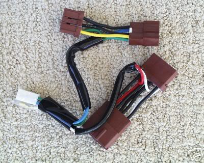

got my turbo timer and harness today few problems. First is that the entire instruction manual is in Japanese [:@]second, i honestly used my manual and searched all over but cant find where my ignition harness is (that i use with my turbo timer). Can anyone tell/show me where its at?

lol, your turbo timer is mad jdm. Iginition wire is black with a yellow stripe and is under the dash behind thesteering wheel if that helps. I think it is hidden by being wrapped in that plastic stuff that keeps wires together and neat.

the harness or the wire? Becasue i got a turbo timer harness for 96-00 and it has two different harnesses it needs to clip into. I'll get a picture up ASAP, but it looks like i need to find two different harnesses.....

Find that wire and follow it to the harness, I think the harness is tucked a little bit and I couldn't really find it when I was installing my alarm so I just tapped the wire because that was all I really needed to find. IIRC it is a brown plug.
theres the harness if that helps.
Thanks for the help BTW, i was looking behind the steering wheel and didnt really find any harnesses but maybe i'll look again next time i go.
