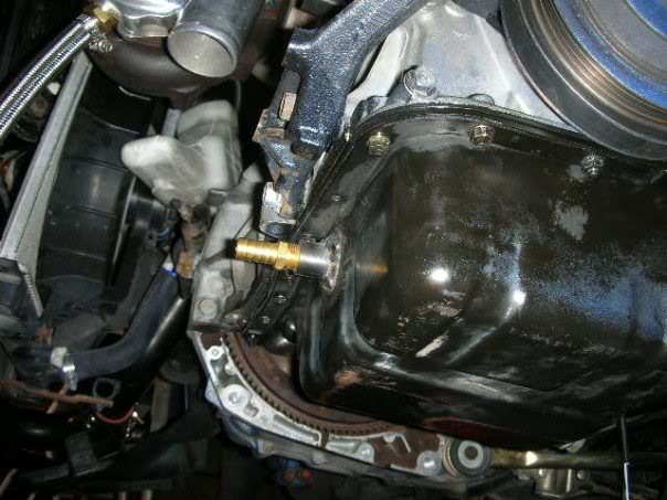

couple new questions:
- can i use the stock o2 sensor bung in the top of the HF manifold for my primary sensor?
- is it totally necesarry to remove the oil pan for the welding/installation of the oil pan drain tap?? Looking at thi picture of Tyler's setup, it doesnt look totally necesarry to me (alot easier, but not required)

Think about it... you have to drill a hole to the oil pan, metal shaving are going to be falling inside the oil pan. Now do you want metal shaving inside your oil pan? lol
