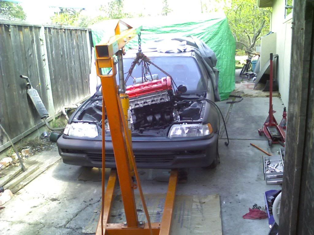

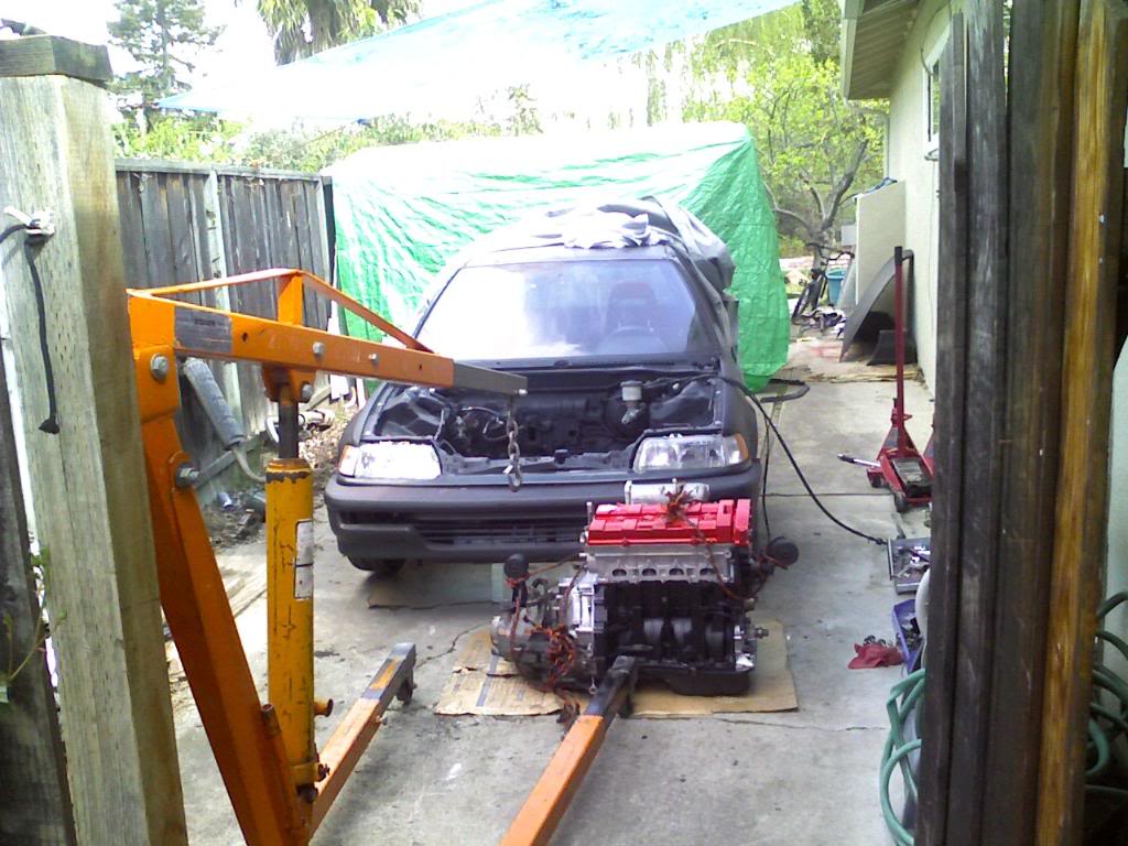

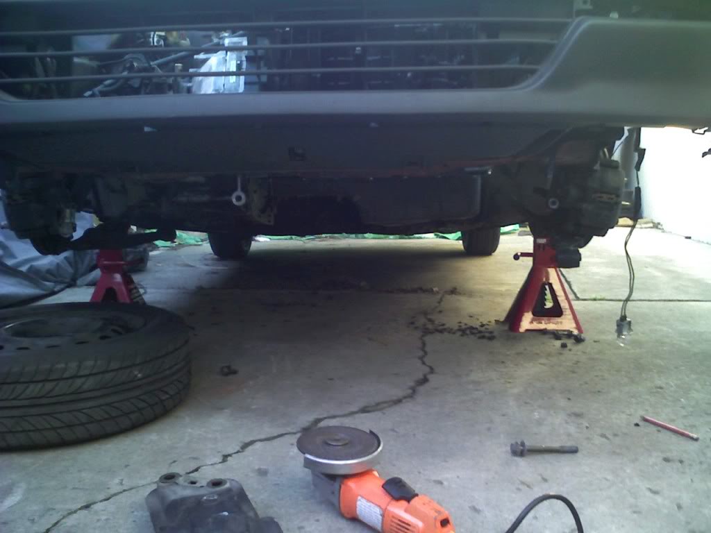

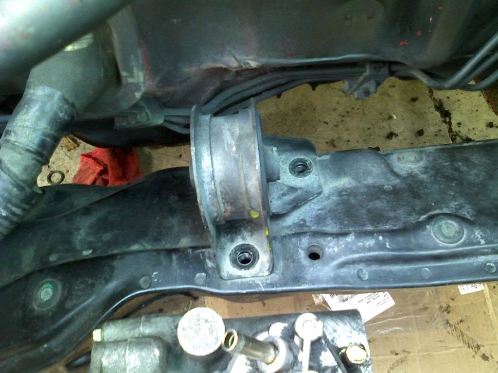

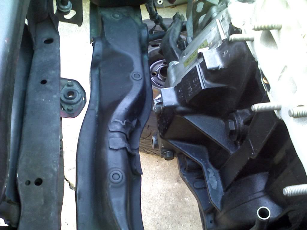

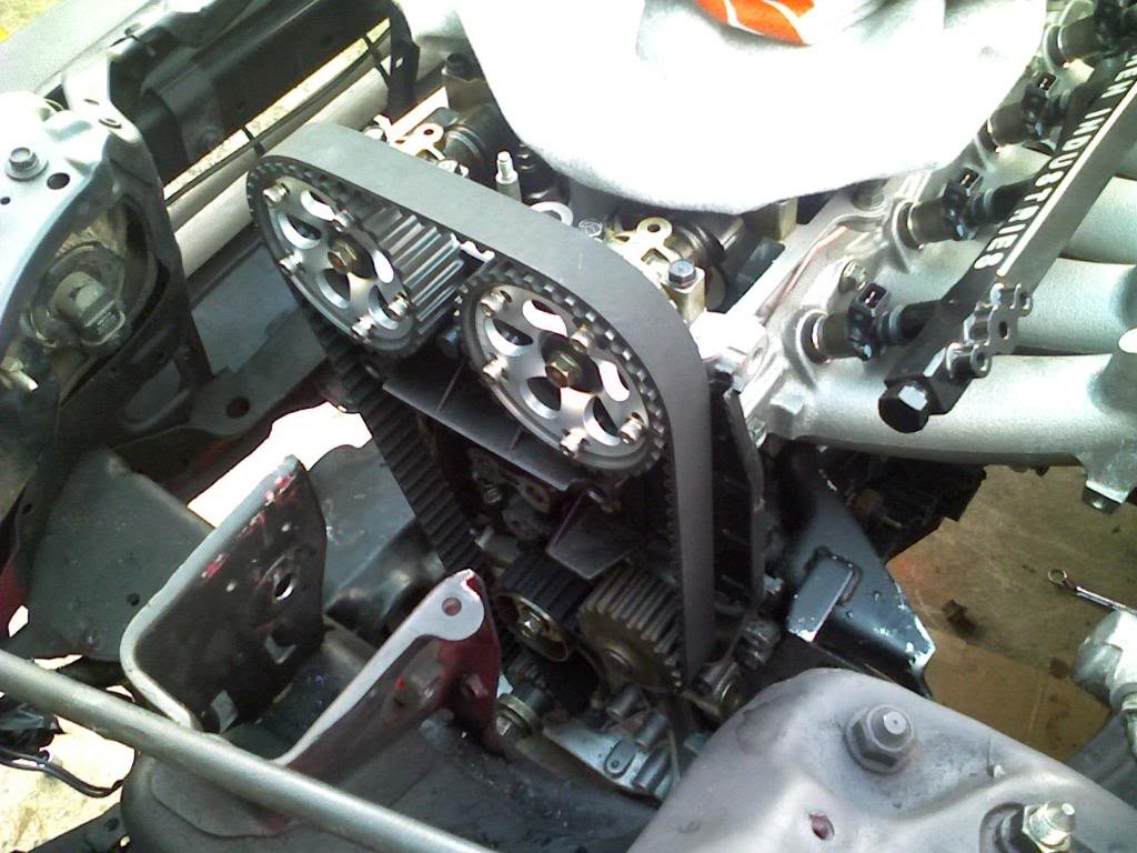

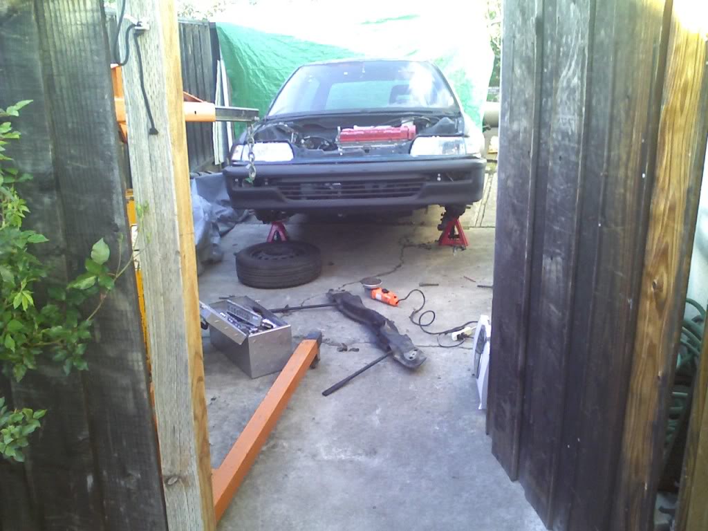

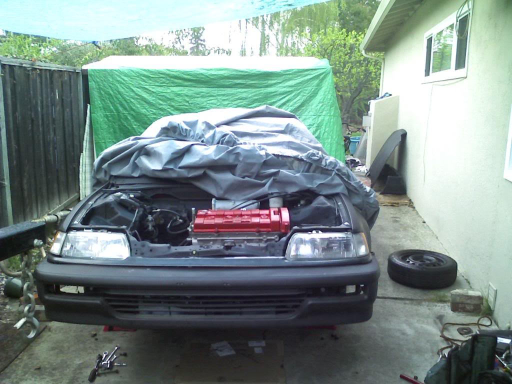

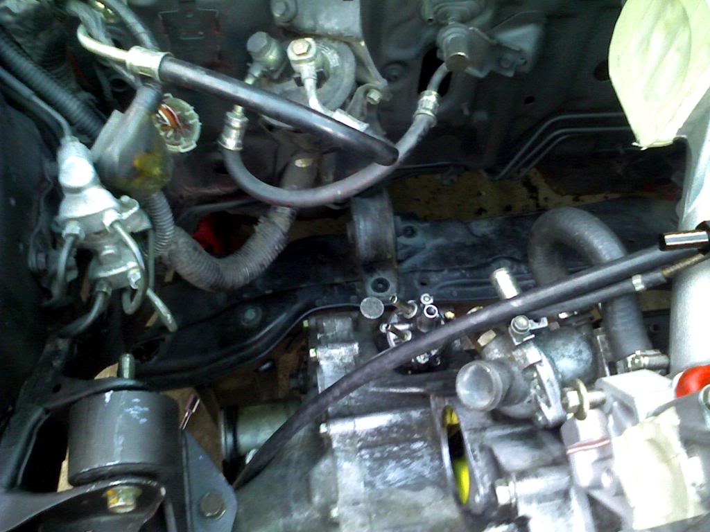

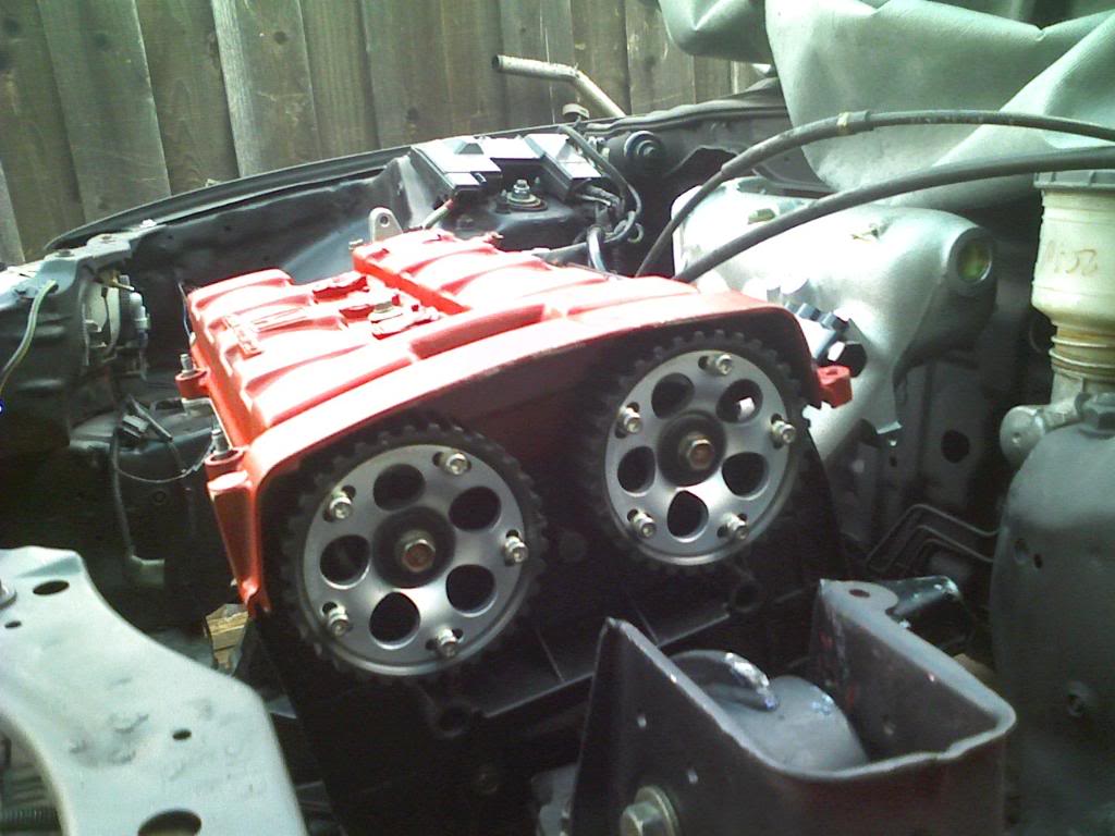

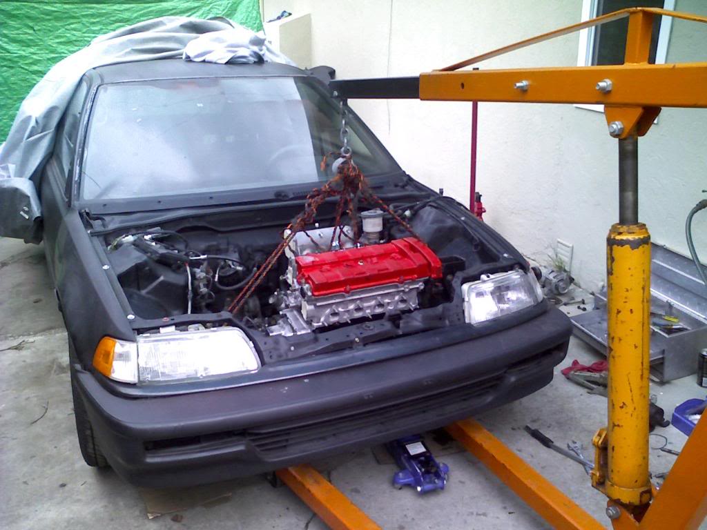

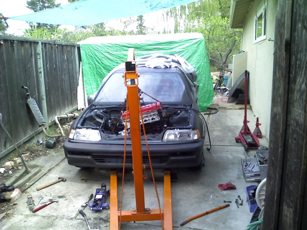

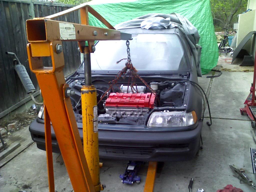

Ok so today I got the motor in, well at least with 2.5 mounts, I'm only using three. Also got the timing belt on. Had to use a gsr belt due to the water pump and such. The gsr belt has 126 teeth while the ls has 125.
Had to pull the subframe down a little bit so that I could get that last stupid bolt out of the rear mount.
So heres some pictures.

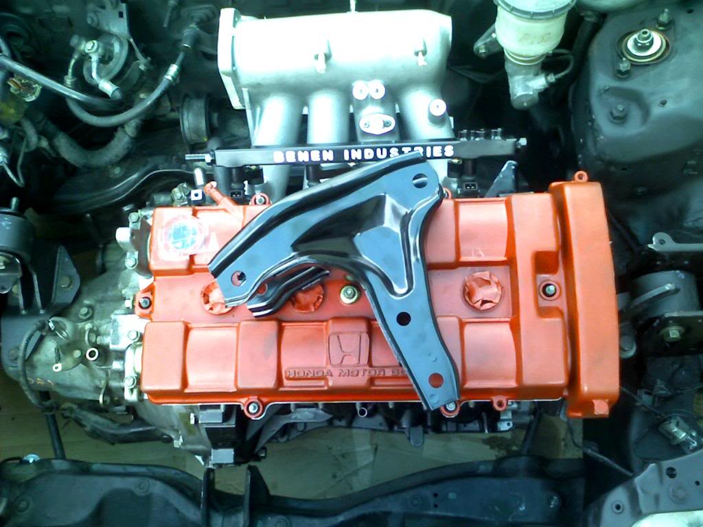

The sir rear bracket to make a bseries fit.
