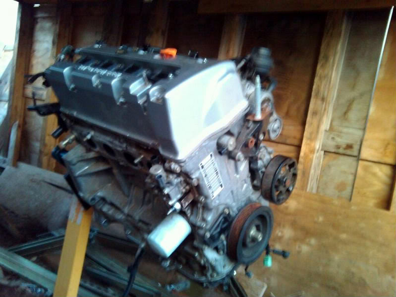

Got the motor today. I was stupid and didn't think to ask if the motor was from the base model rsx. It is. So that means its a K20a3. 160hp and 140tq. Not what I had in my head. I have a couple options now. 1. Sell it and buy a different K series. 2. Swap it as usual. 3. Swap it and sometime down the road and save for a2 cams, extra set of a3 rockers and Kpro to make a Killer vtec setup that has been dynoed at around 210whp stock.
You guys think it's a waste? Or worth it....

Okay so I thought about it all day at work and since it's such a clean low mile motor, I'm gonna keep it. I'll just go through the process of getting everything together to swap it over the next couple months. Once it's swapped I'll enjoy for a little while and then save for an OEM vtec killer setup and Kpro. Pics of the motor tomorrow!!!! Too dark right now.

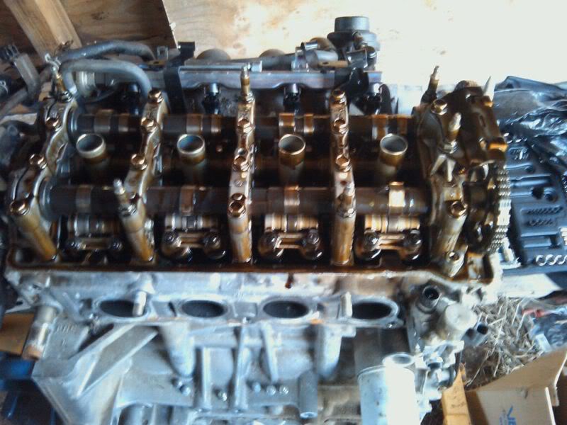

Started taking off things I wont be needing like random brackets, exhaust manifold, etc. Removed the wiring harness. Gonna clean it up and remove anything I wont need.
Everything inside looks fresh and like it really only has 26k miles.

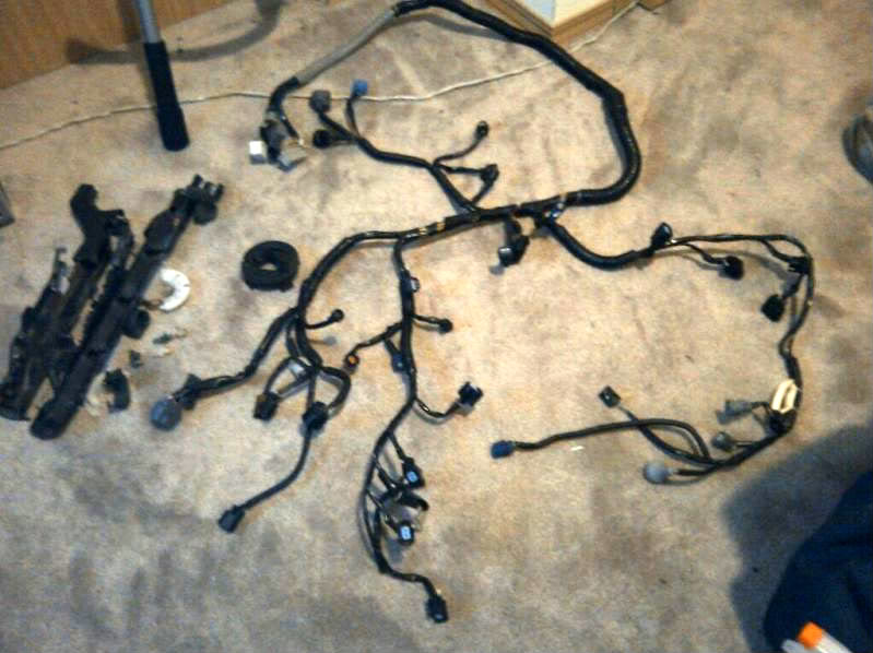

Took the wiring harness off, cleaned it up, removed all the clips/zip ties, grommets and such. I don't mind the factory plastic and electrical tape as long as its clean.
