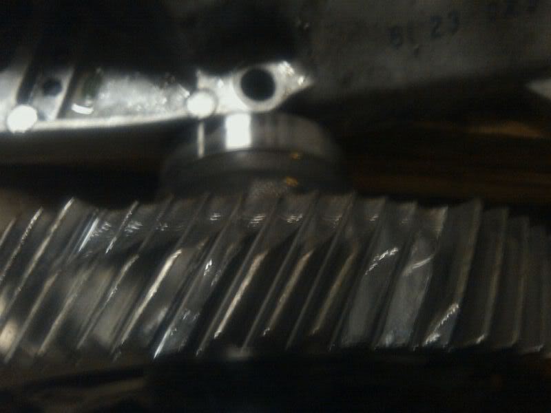

Well more bad news. Put the new tranny in and found another problem. When I drove it I noticed a popping/clunking noise from the tranny/axle area. It happens in any gear and neutral, just not reverse. The axles and half shaft look normal when I took them back out and the noise still occurs when I put them back. If I jack the front of the car up and turn either wheel forward, the noise occurs about every two rotations of the tire. It doesnt occur when one side is out, only when both are in the tranny. Which leads me to believe it is the ring gear. I talked to the person I bought it from (works at a shop) and he said it worked perfect for him and never had a problem. I'm stumped and don't wanna have to pull this thing back out again.

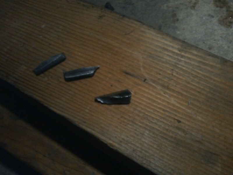

I finally got the motivation to pull the swap out AGAIN. Pulled the tranny apart and found that the final drive has roughly 10 broken teeth. I bought it locally from someone I met on K20a.org. I texted him and sent pictures and he is going to try and get me a new final drive or pay me the difference. Regardless I'm gonna order one now because I'm sick of not having my car. I've been to hell and back, I don't see how I still want to drive this thing but somehow I still want this done.

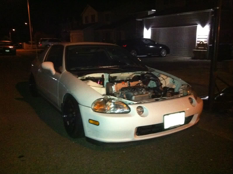

Well guys, after all this time she's finally running . I got my third, yes, third transmission today and put it in tonight after work. She runs great and finally I'll get back into the swing of things. I also tucked my HID ballasts and the headlight harnesses. The engine bay is a lot cleaner looking now. Need to have an exhaust made here soon and I ordered a Karcepts throttle cable bracket.
