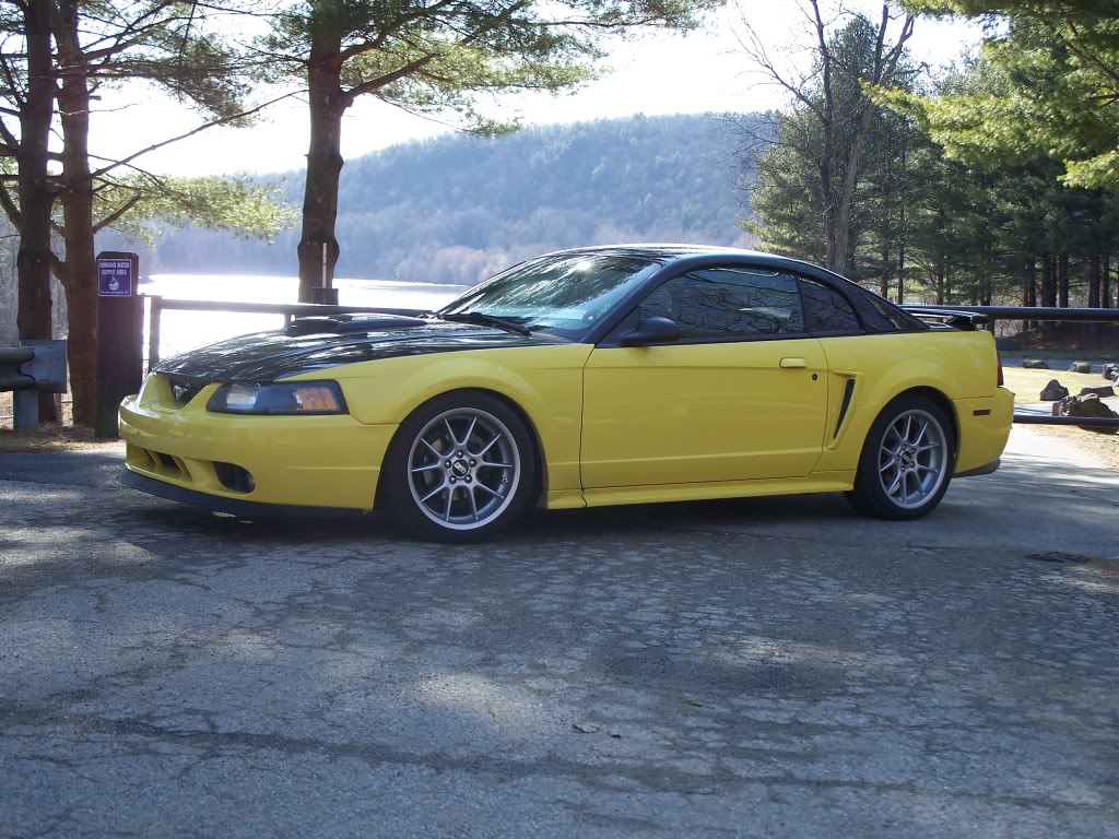

Anyway, I don't think I mentioned it, but the new paint job is actually being bumped up to next year instead of the end of the project. The reason being is that I'll have the new body parts (front bumper, hood, mirrors, side skirts, side scoops, trunk, spoiler) that will need paint, so I might as well just have the whole car sprayed down. My friend Jack (he does auto body and is quite good with a spraygun) said he'd do the car for $150 plus the cost of paint. Right now, I'm thinking two tone; the stock Performance red on the body, keep exposed carbon fiber to make up the blackout panels on the hood and trunk, and gloss black on the roof, A-pillar, and sail panel.
For the roof, I'm thinking something like this:
i like the 2 tone scheme. ive been thinking of doing my civic like that but just to hard to get it to flow right.
hows the rear paint going to flow? thats the hardest part to flow clean IMO.
Well, the c-pillar on new edge mustangs is actually a separate piece, so there's a hard body line there. I'm thinking it should look decently clean just painting the a-pillar, roof, and sail panel. Then the top of the trunk deck, long-tail spoiler, and sides of the hood will all still be red.
