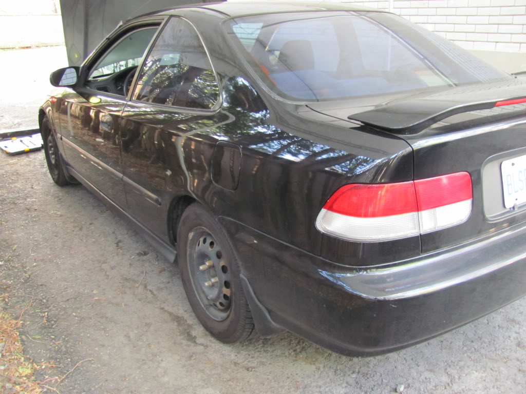

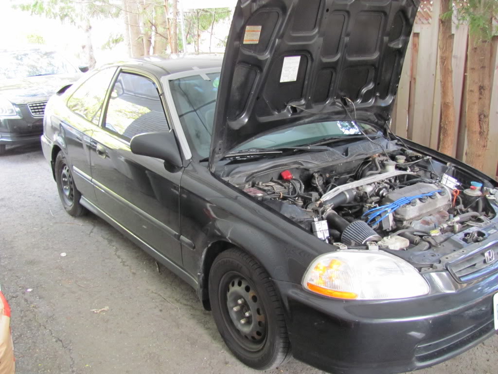

so i picked up a 98 civic for cheap
figured id get right into her and start making the magic work.

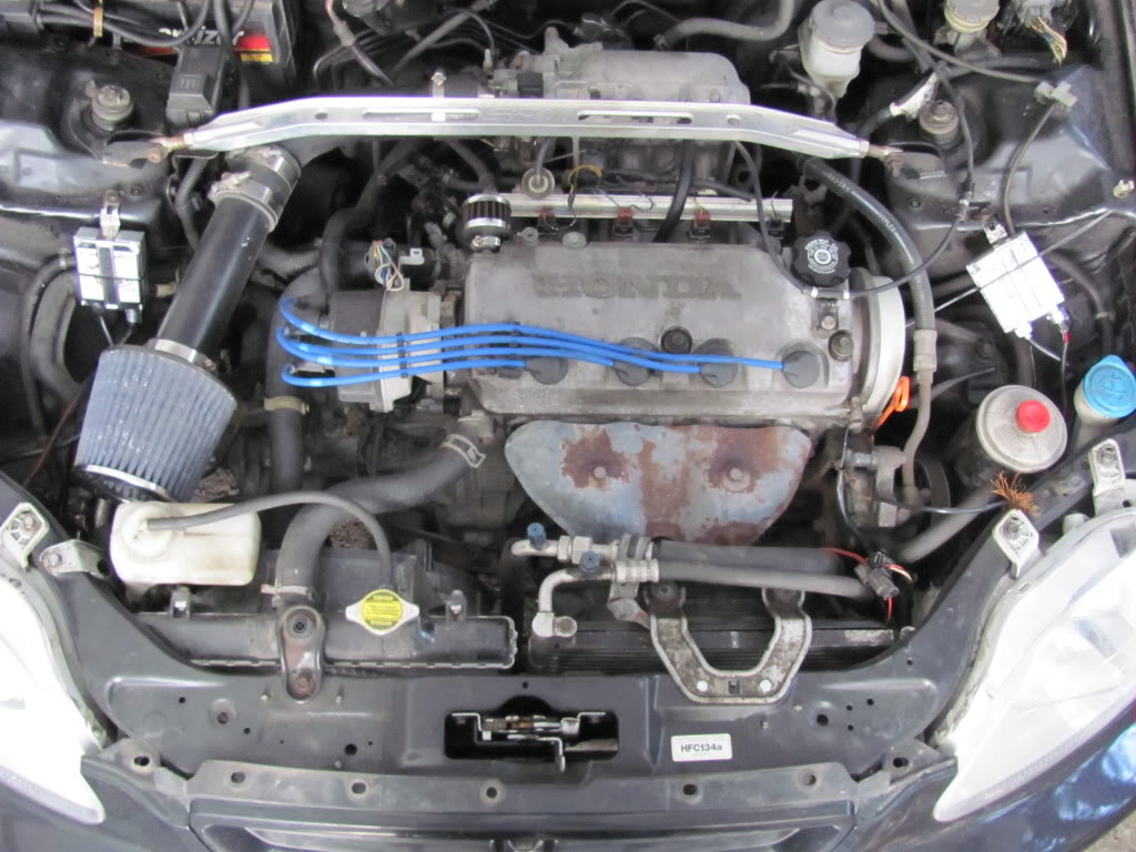

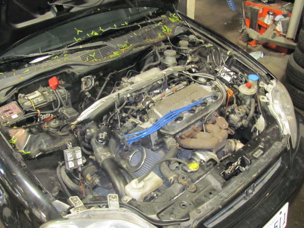

engine is a d16y7
i put a y8 intake on

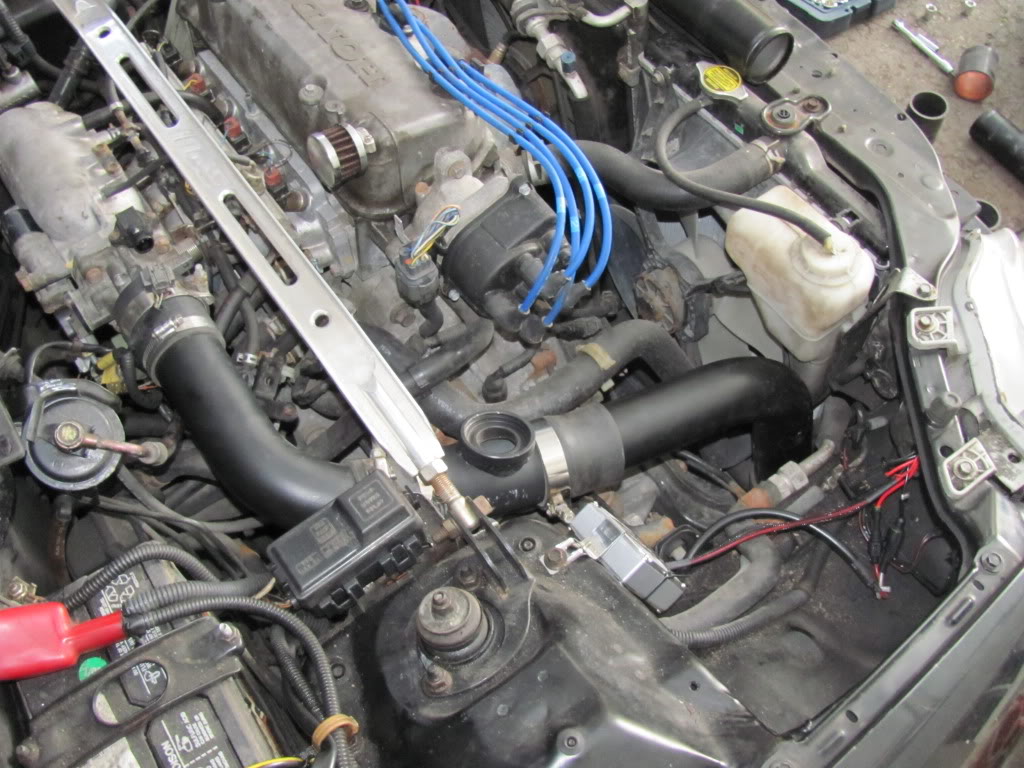

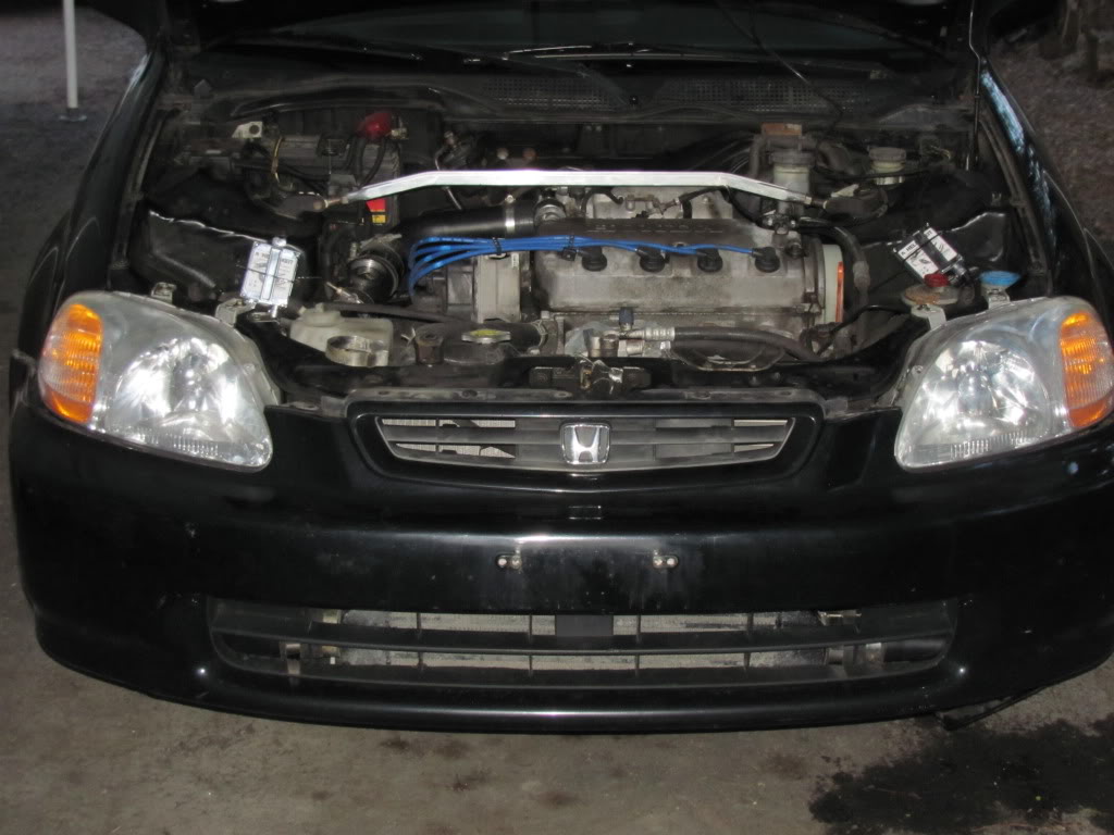

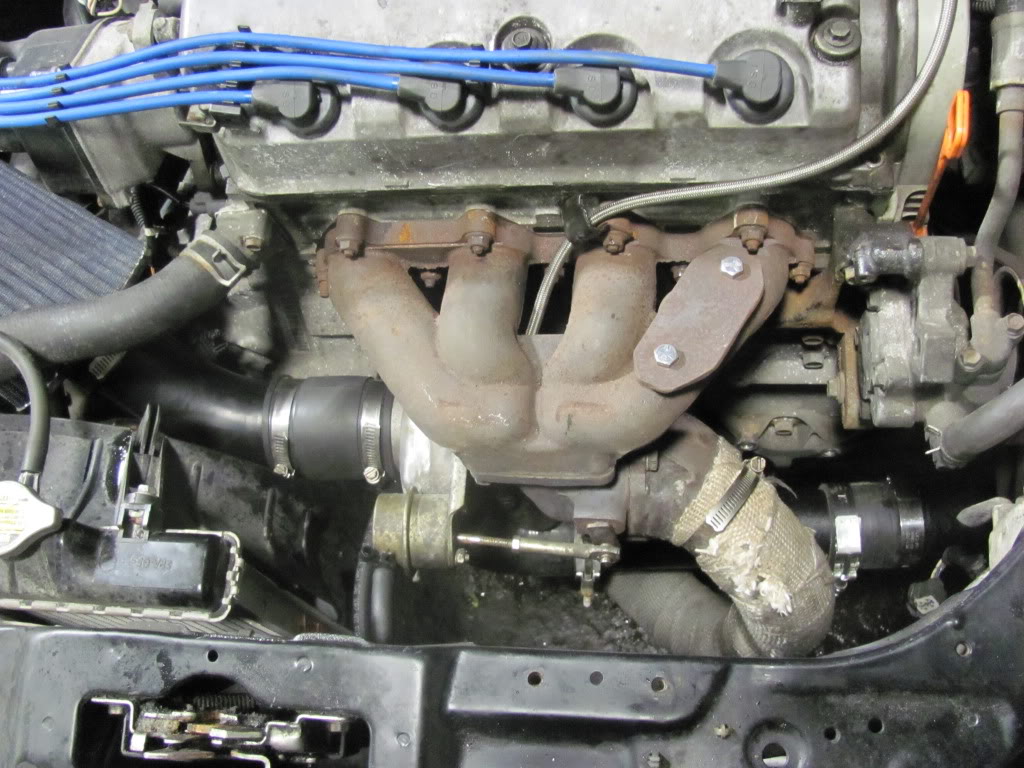

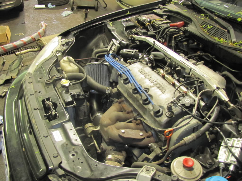

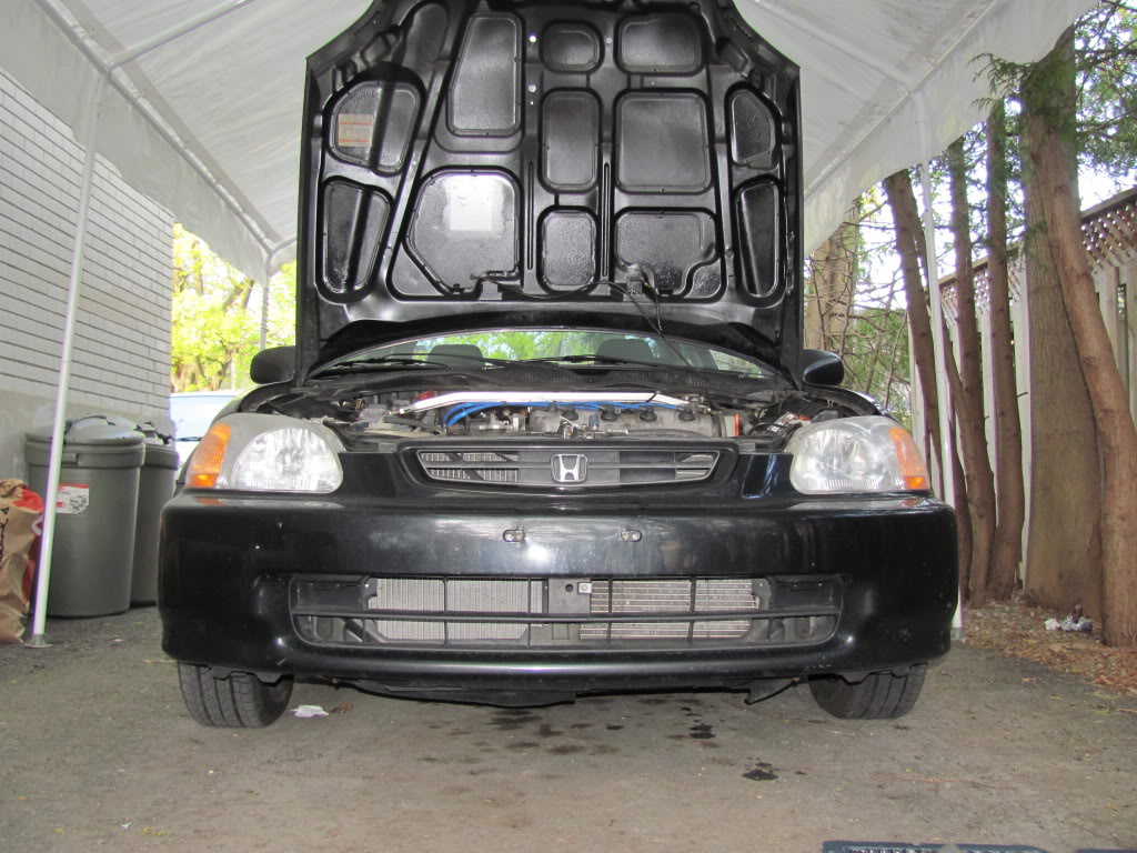

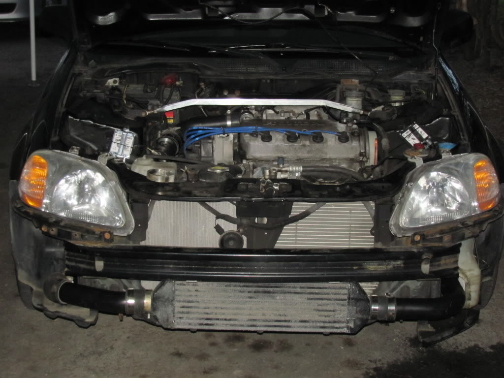

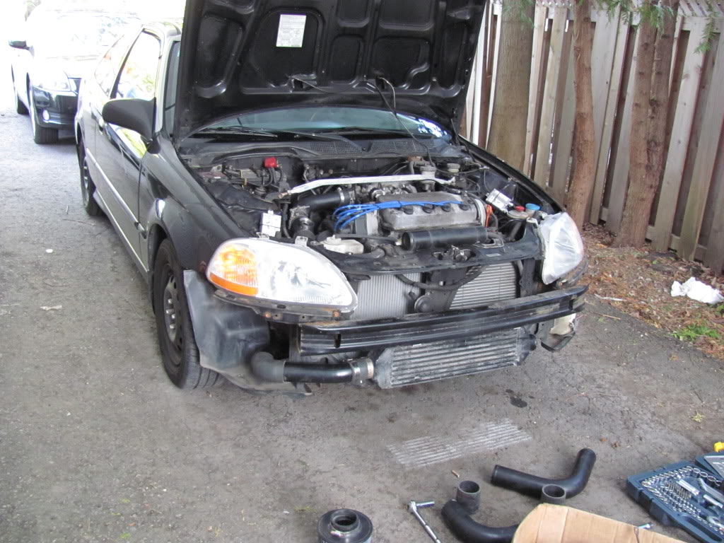

mount the intercooler and run the c/p

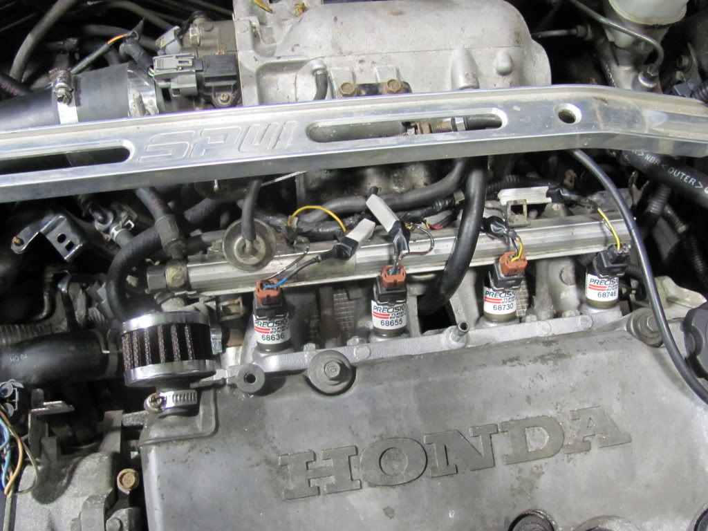

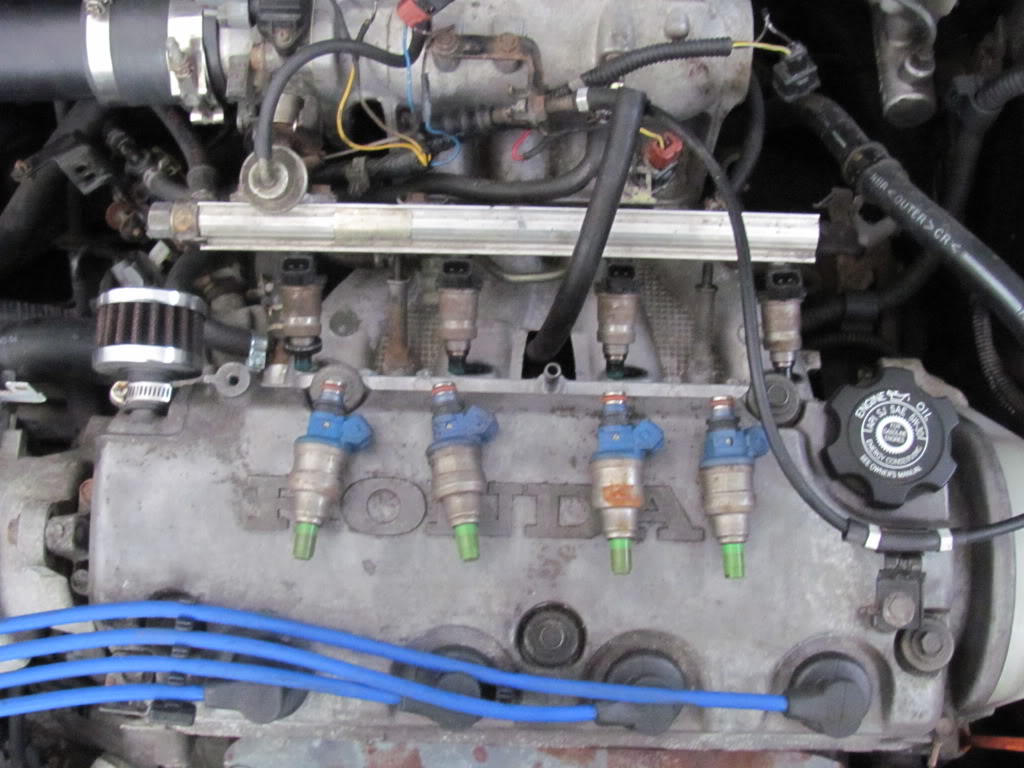

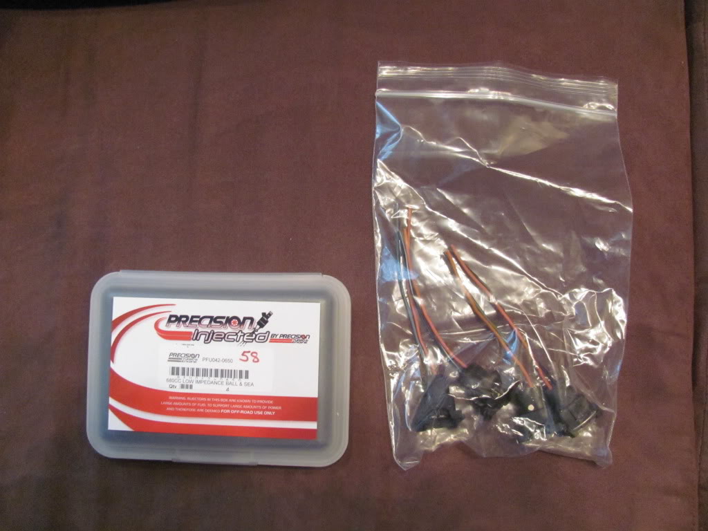

i installed these 360cc injectors.... and im not a fan... so im going to take them out and i bought 680CC precision peakhold injectors which should be coming sometime next week

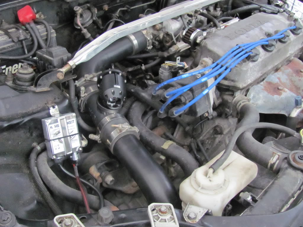

Nice stuff man.

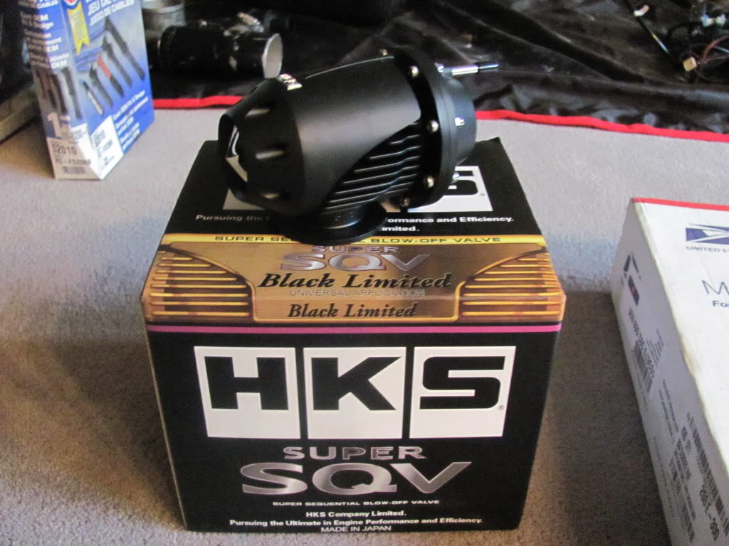

You haz s300? I love that BOV btw. The black edition makes it look so much nicer.

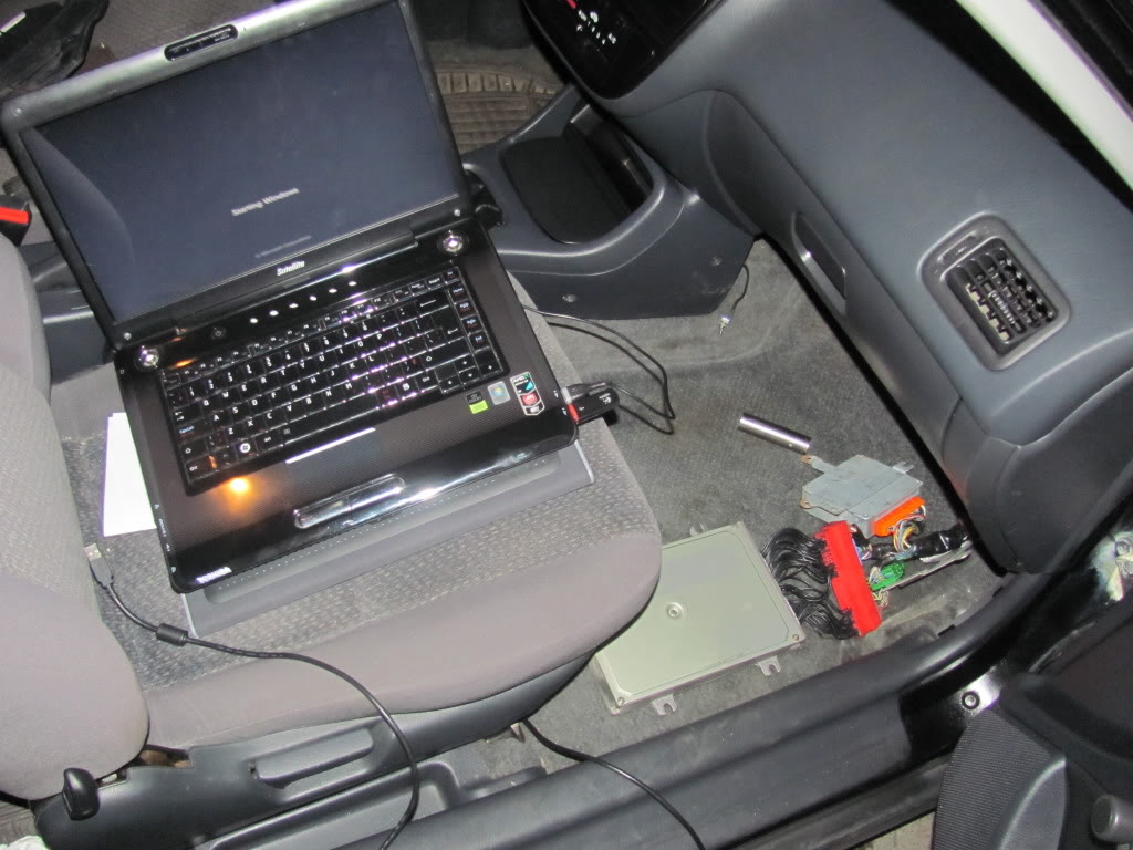

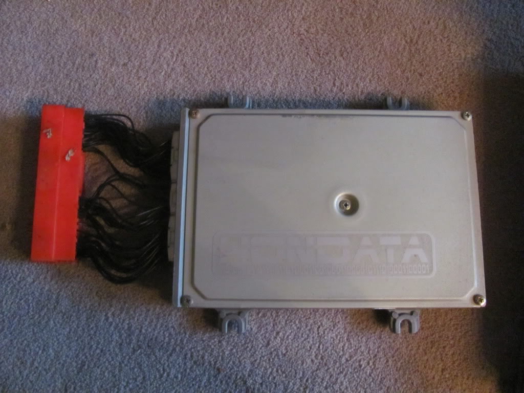

yea, car runs on obd1 s300 ecu right now, i still need to run the coolant lines to the iac idles a little funny, i wired in my wideban o2 and my boost gauge today. car runs really lean with these injectors, i think there tired or weak.. so im going to wait for my new injectors so i can get my car to run right. im tring to get the sucker boosted before end of may, but rain is slowing me down cuz im doing it all outside lol. once i have more pics ill post.
yea, i saw that bov and i was like I WANT!!!!!! i have the chrome one, but i love the black hks one. so i sold the other one lol

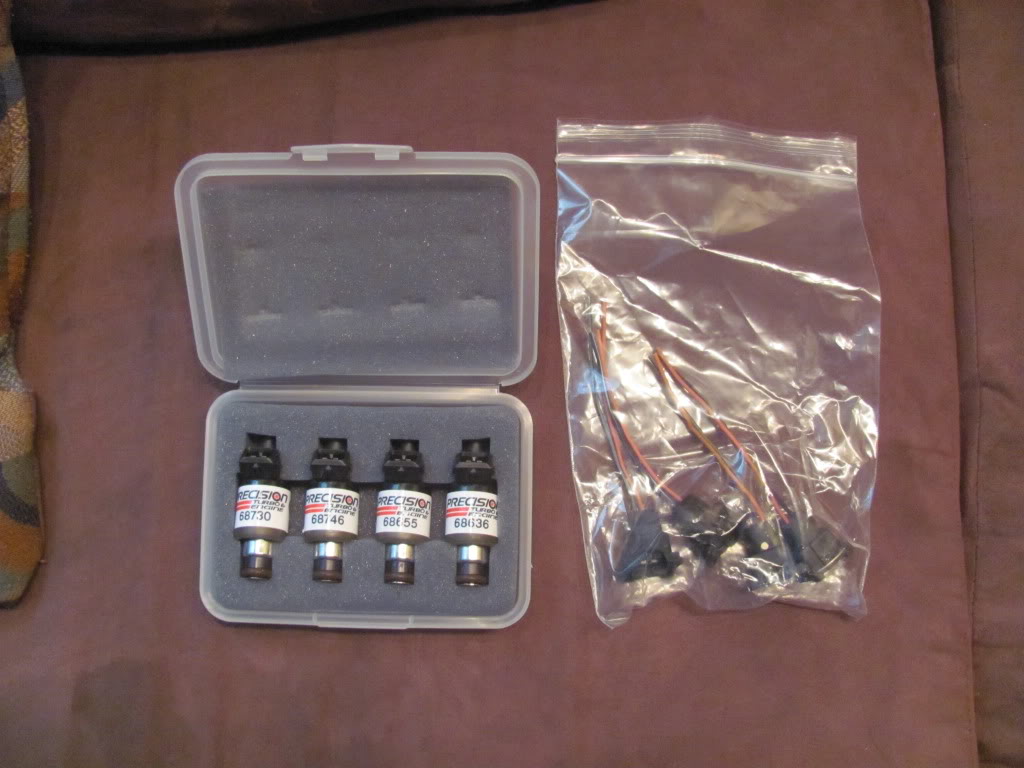

got these in the mail the other day, will be installing them on tuesday!

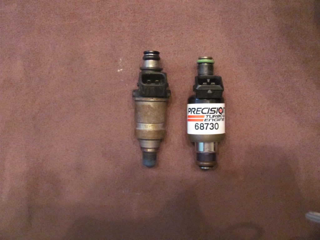

stock vs 680cc

installed my 680cc injectors and building a basemap for it to run na right now. got it running kinda good, little lean at partial throttle...like 15.4 on the highway so... ill still fool around with that but this is how it runs as of right now. launch control is set at 4700 rpm right now
YouTube - ‪hondata s300 test‬‏
i have all the charge piping hooked up to the point of the washer resivoir so there is alot of restriction right now

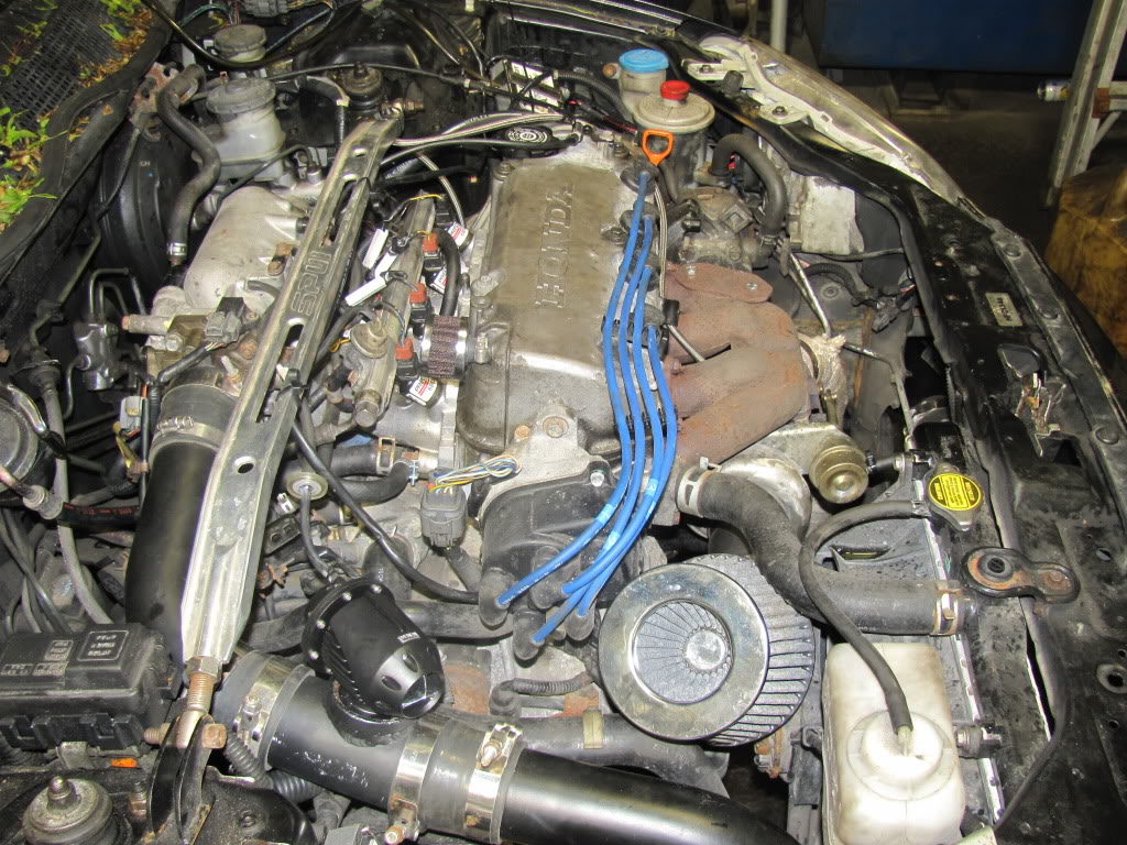

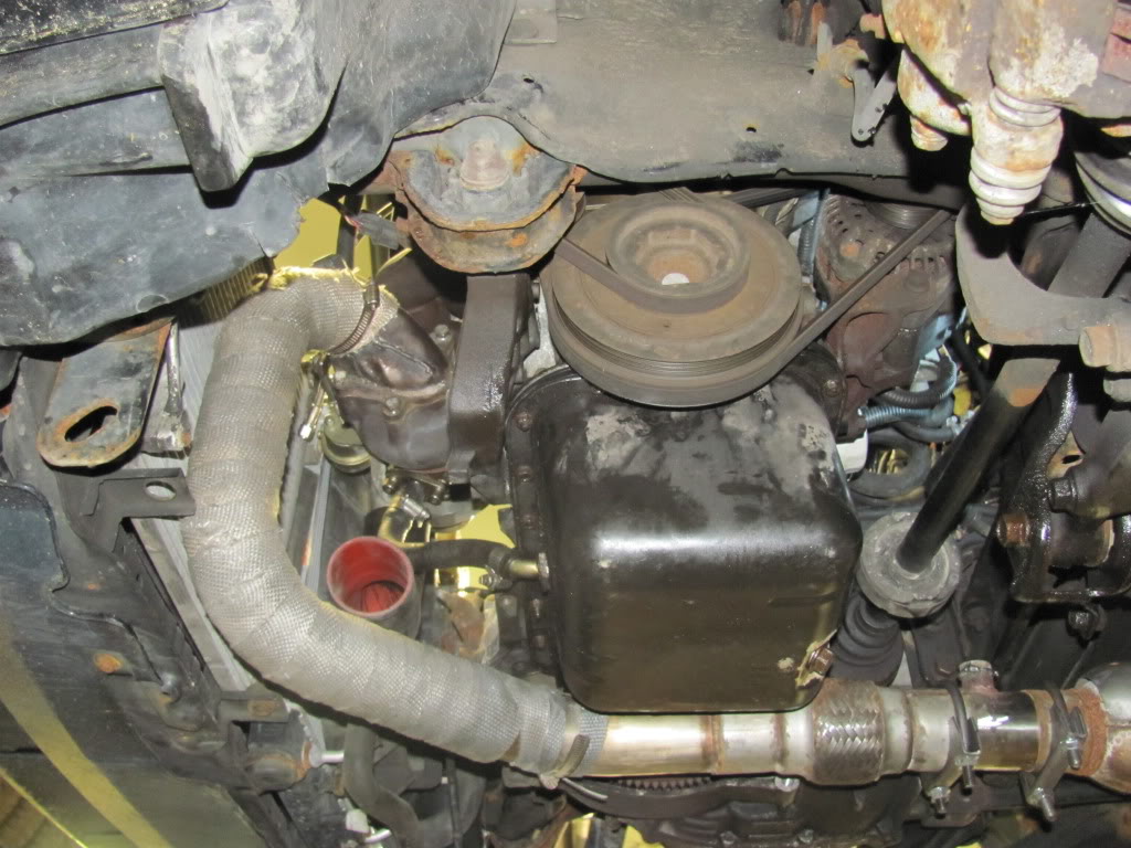

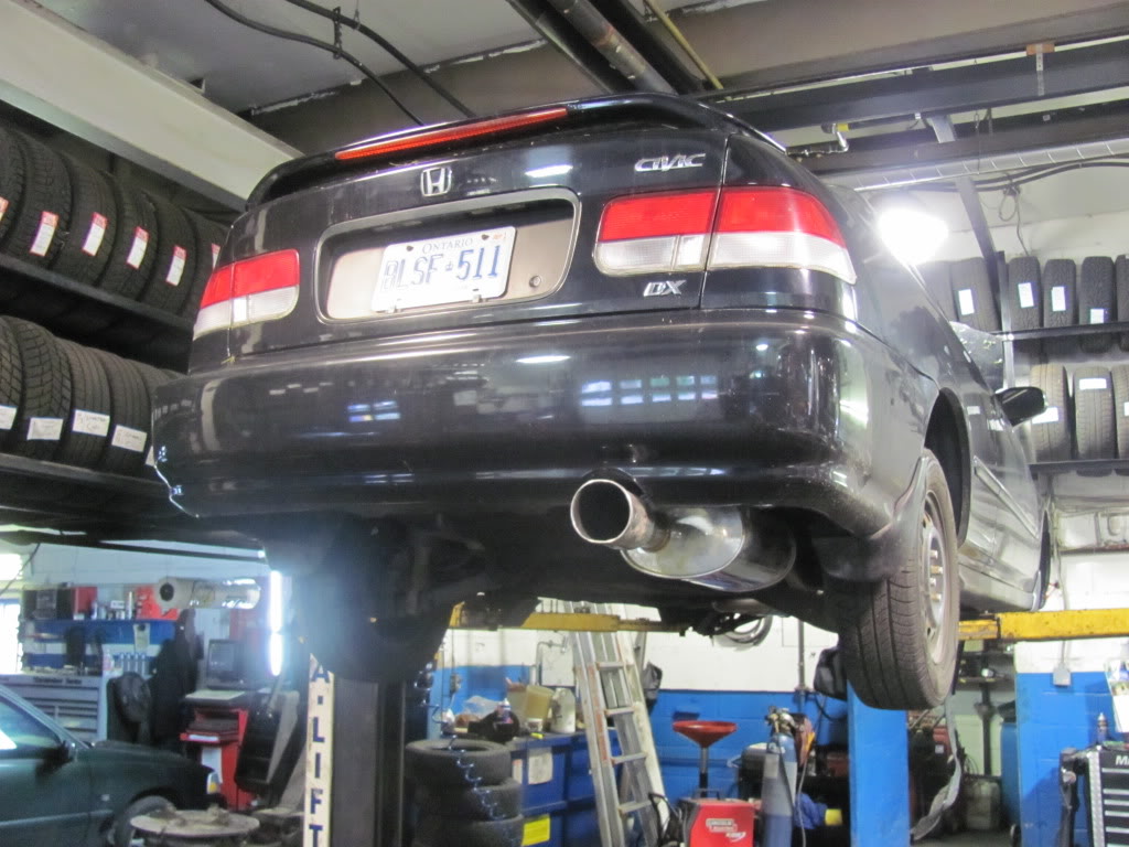

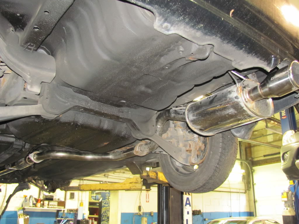

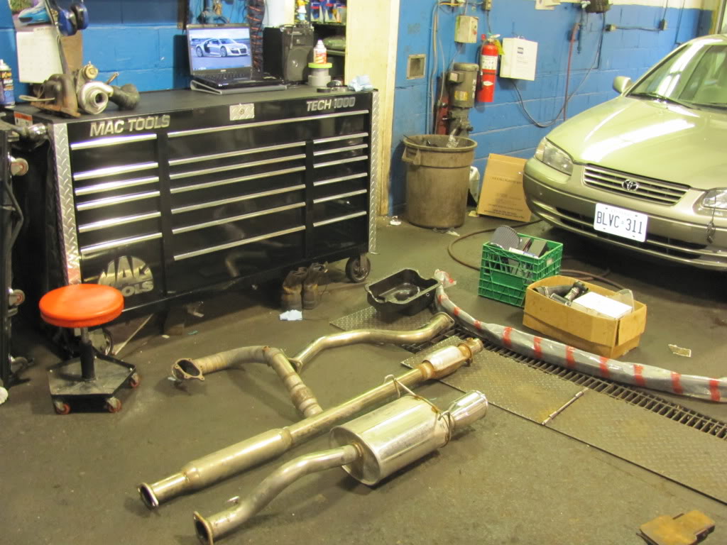

offically turbo'd 7psi, on a basemap i managed to make somehow lol. runs really rich at boost 11:2-11:6 but thats where i will have my friend driving it while i do some more tuning
anyways here are the rest of the pics and me just driving around on a couple streets doing 1/2 to 3/4 throttle pulls.

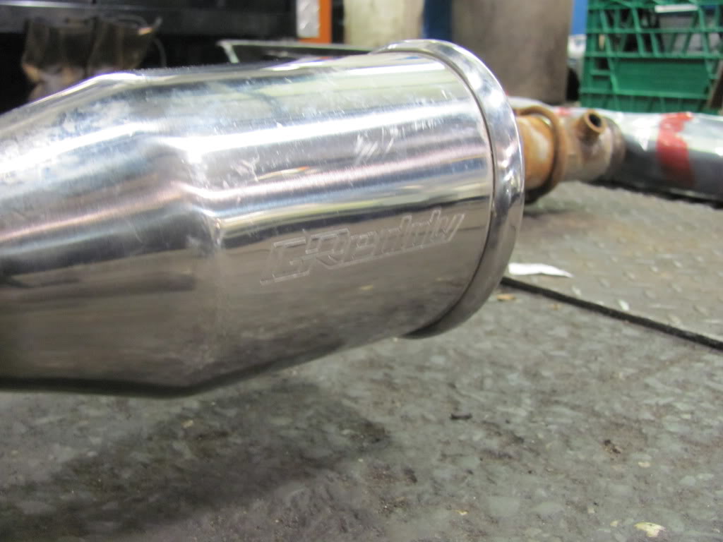

getting ready to install the SP2 greddy exhaust
