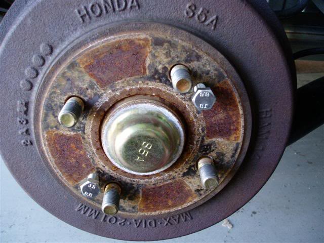

So my squealing brakes drive me crazy, i assumed they were the rears:
But it was not my rears, I guess the front right brake is not properly set on the rotor, i did the breaking in process and I have gotten them red hot since (not on purpose really, canyon driving) and it still squeals, so i will have to deal with it until i can resurface the rotors i guess....

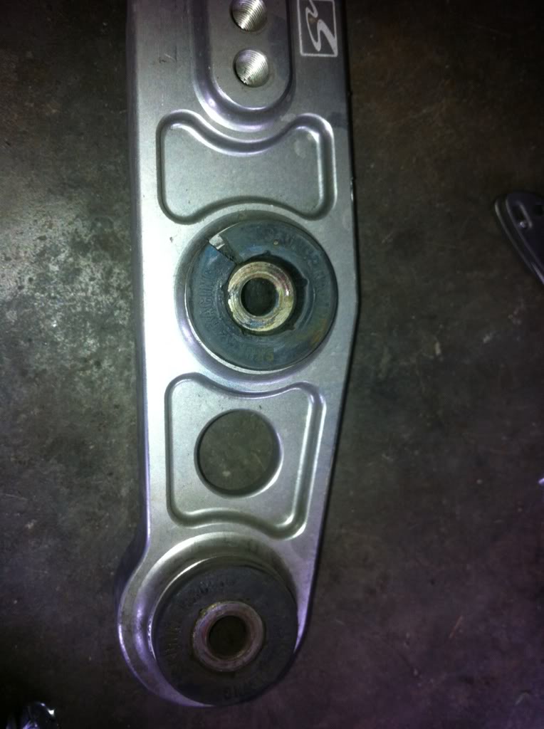

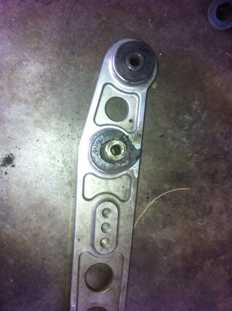

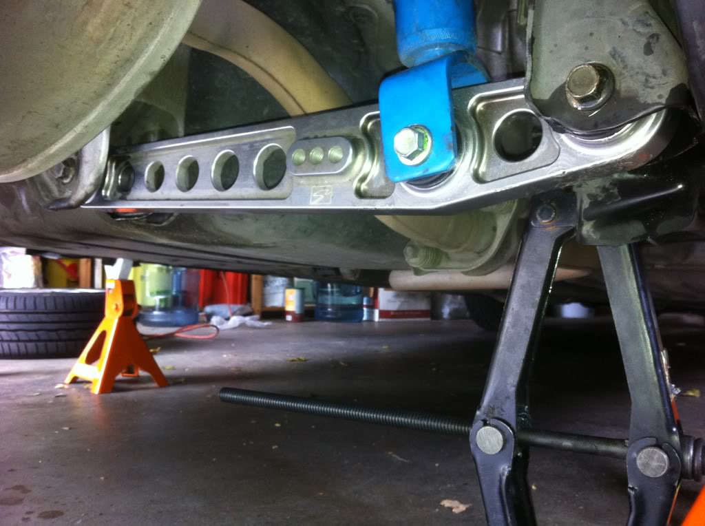

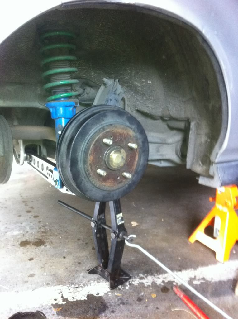

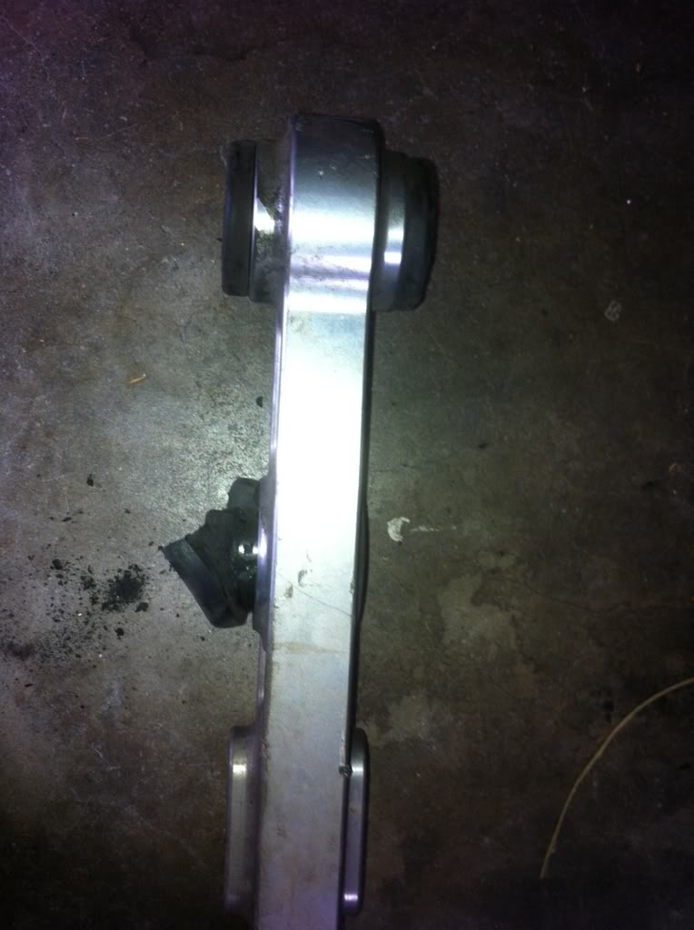

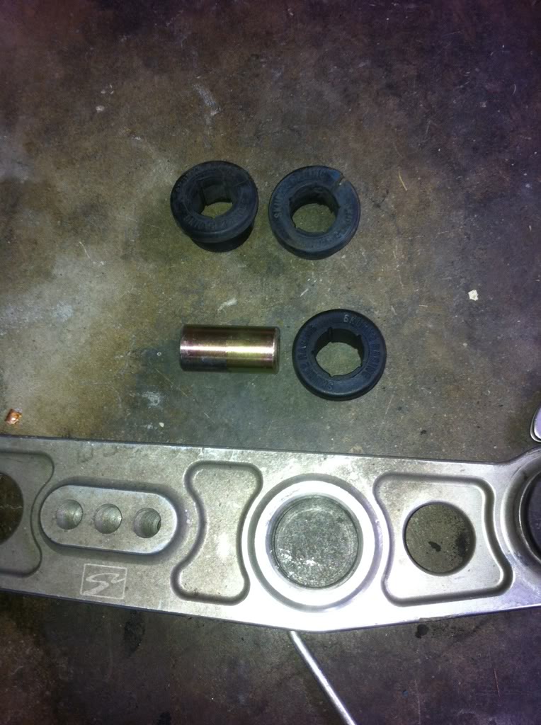

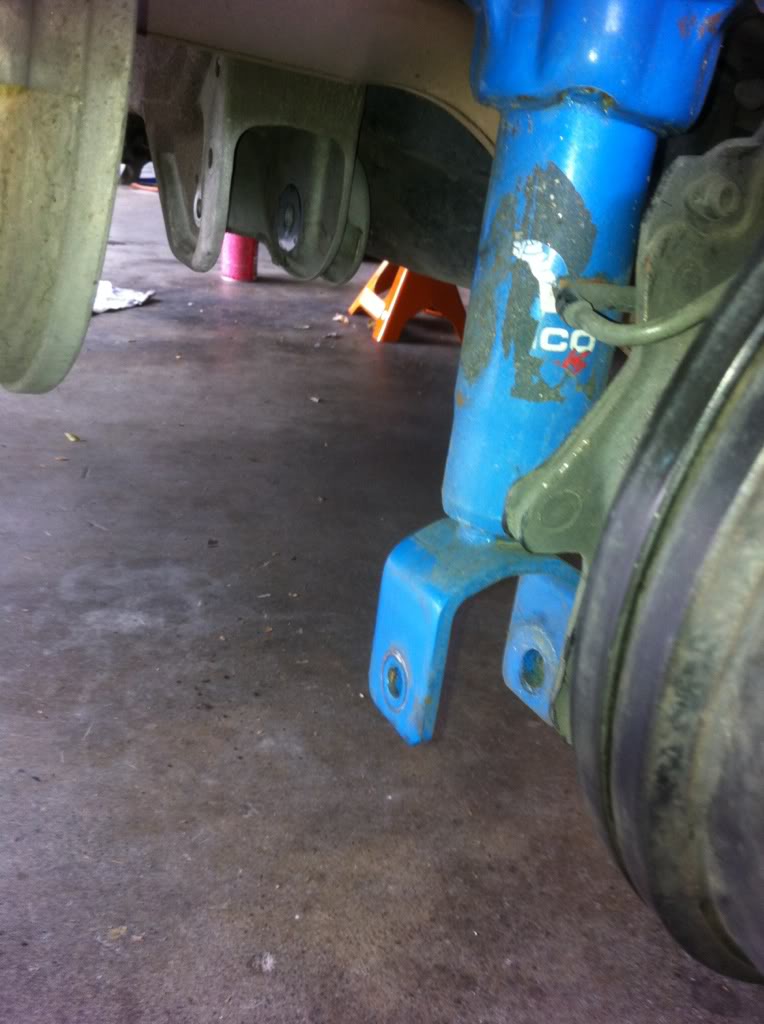

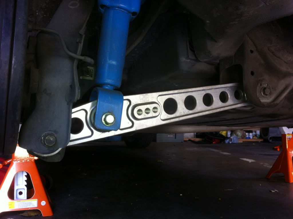

but I did replace my bushings on the lower control arm:

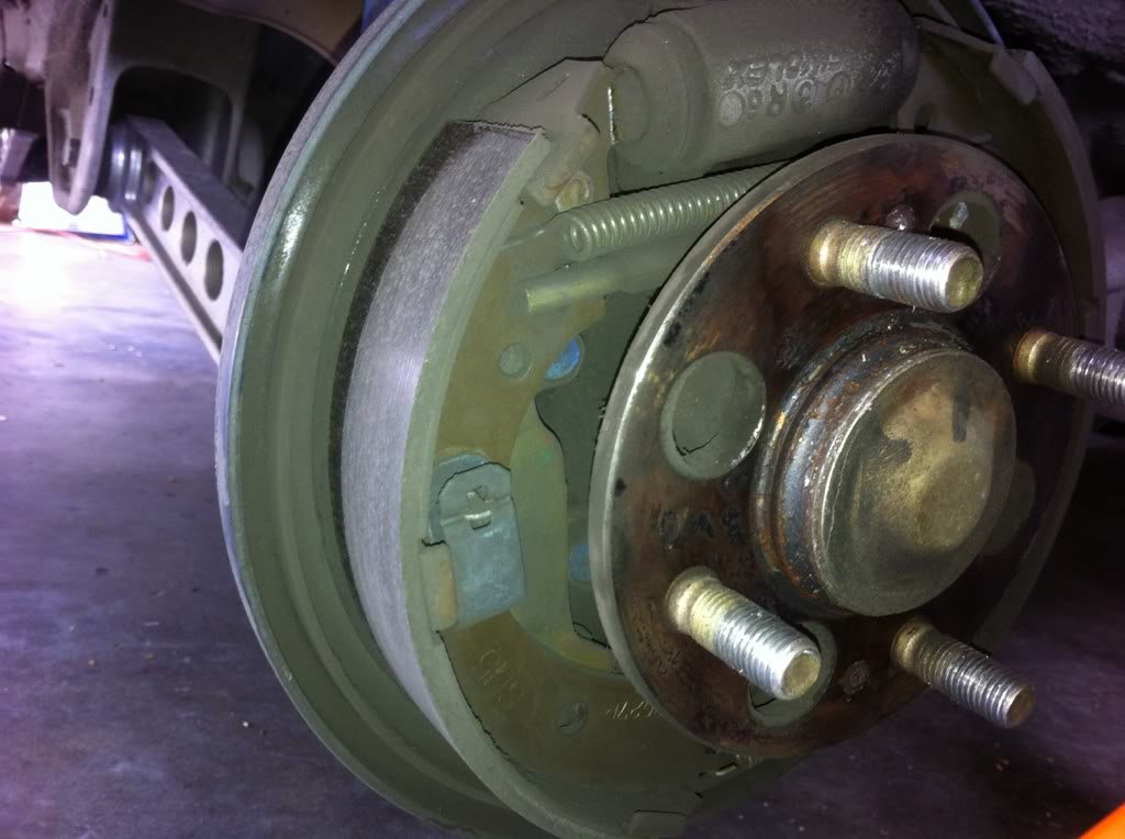

edit: looking back i think my control arms were upside down in the car -_- it was my first mod to the car... but it sits lower now. and i do not want to deal with drum brakes ever again, def switching to rear disc one day. but while i was in there i did clean both drum interiors with brake cleaner and i do not hear any squealing when braking so far, also no squeaking from bushing which is a huge improvement.

Nice work. Make sure you do not tighten the bolts as the car is up in the air. I assume the jack is in the last pic showing that you are pre-loading the suspension?
My Skunk2 LCAs have been on for the past 2 years and the bushings look fine so far. I do need to get back there and clean/lubricate everything though.

That is the preload, it was as high as it normally sits (as far as i can tell). So I hope that will suffice.
You can see in the first pic though that the LCA is upside down, so there was extra strain on the strut bushing, i think that is why that is the only one that want bad. So happy there is no more squeaking at every bump.
Forgot to take pics of the drum brake clean, but it was much nicer looking, Im guessing it doesnt hurt to get in there and clean them once in a while.

hmm.. yeah.. those definately look upside down. I hate seeing people dealing with cracked LCA bushings, it looks like something that would really **** me off.

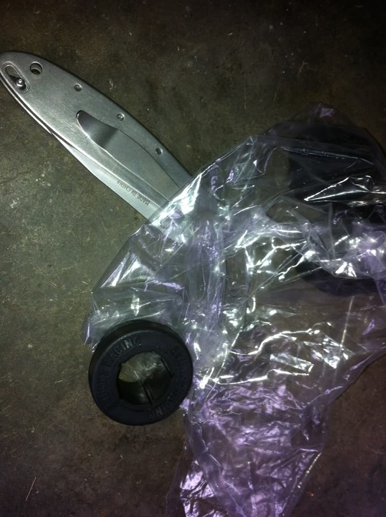

You know I was expecting it to suck, but my bolts all popped right off, the LCA dropped right out and using a pocket knife I was able to pry out the skunk2 bushing very quickly, popping it back in was a little bit of trouble only on the mount under the drum brake, but overall it took me less than an hour.
