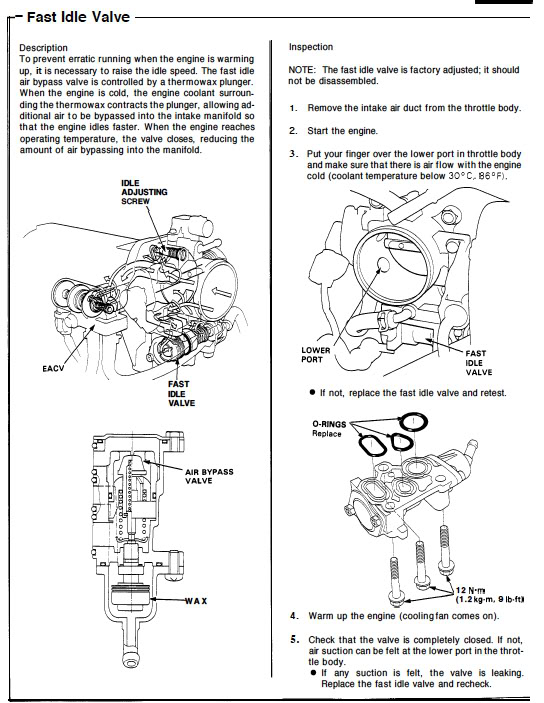

Try bleeding the cooling system, cleaning the IACV, and checking the fast idle valve:
