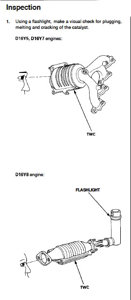

No, this code would typically only produce emission problems, although a clogged cat could lead to loss of power.
What's the best way to troubleshoot this then?
Carefully inspect the exhaust system upstream of the cat for cracks or holes. If none is found, then pull off the cat and inspect it:
Could it lead to no starting or just loss of power? I'm most concerned with getting the car started at this point although I do want to address that problem as well. Upon visual inspection without removing it, the cat. conv. looks pretty darn rusted and corroded.

I have never heard that a clogged cat would cause a no-start problem. While blocking all exhaust flow could theoretically prevent starting, I have never heard of a cat that is completely sealed closed.
Upon visual inspection without removing it, the cat. conv. looks pretty darn rusted and corroded. Is it pretty easy to remove?
The job is easy if the bolts are easily removed. If the exhaust and exhaust manifold bolts are very rusty, use a lot of penetrating lubricant. Also be prepared to break some bolts.

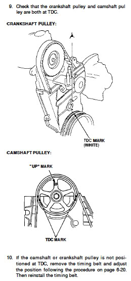

Are you sure that the fuel pump is priming for a few seconds when the ignition key is turned to position II? Measure the fuel pressure and check whether the timing belt is synchronizing the cam and crank exactly at TDC.
I can hear the fuel pump, plus I had plenty of fuel on me when I cahnge the fuel filter last night.
How would I measure fuel pressure? Also, could you explain the timing issue you brought up?
Could there be an easy timing thing to check in the distributor?
How old and how many miles on the timing belt? You need to remove the valve cover and upper timing belt cover to inspect:
