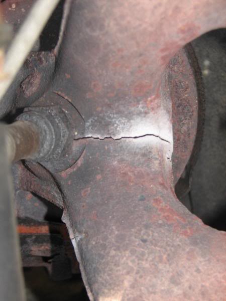

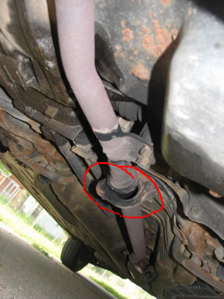

Alrighty, so for months I've been talking about upgrading my exhaust to a Megan Racing drift spec and my header to a Megan 4-2-1. I've been putting it off even though my header had a crack in it just due to money issues. Well now I have another problem aside from my cracked header. I got ready to go to work today and I noticed that when I started my car, it sounded like I went on Ebay and bought a $20 fart can and slapped it on. I though it was possbly the crack in the header had gotten worse due to recent rain and temp changes. Needless to say I ended up taking my mom's car to work and left mine at home. I had my dad take a look at it while I was at work and he discoved that a flange had let go.
When I got home I jacked up my car and took some pics.
Here's the section of my exhaust that let go:
Is there any way to temporarily repair it til I get all of my stuff for my exhaust conversion?
And here's a couple pics
of my cracked header:

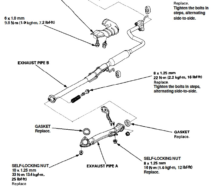

Regarding the fart can noise, I think replacing exhaust pipe A is the solution. As a temporary fix, try to pick up an inexpensive used pipe from a salvage yard.

well for a quick fix for the joint.... try a muffler shop if they can just weld the flange back onto the header... thats odd... ive never seen a header crack and it bust apart... WFT you done to that thing.LOL
but the cracked header at least doesnt look to bad..... at least there is no black soot so its not leaking out the cracks yet....
You can't see it in the pic but there is a bit of soot being blown onto the front of the engine. I just ordered my megan header, so that should hopefully be here by the end of the week. I'm still trying to find a good price on a Cat. I'm probably going to go with a Magnaflow cat if I can find a good deal on one online. I'm debating on getting one from Partstrain.com and having my dad weld it since it's not a direct bolt on.
