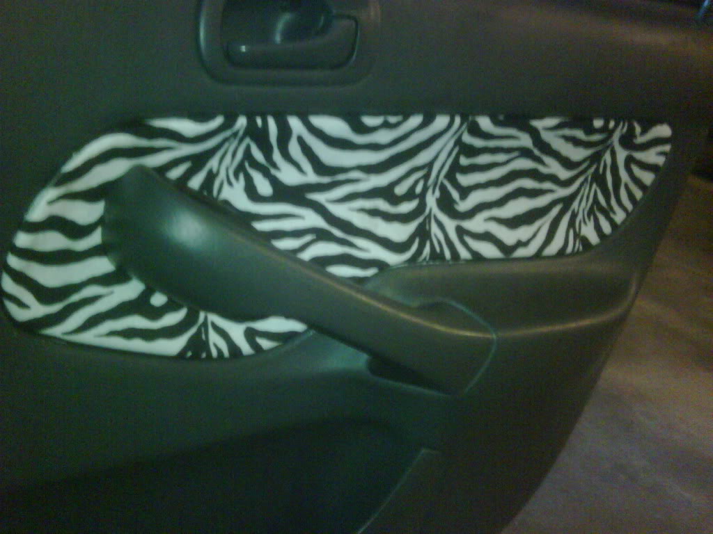

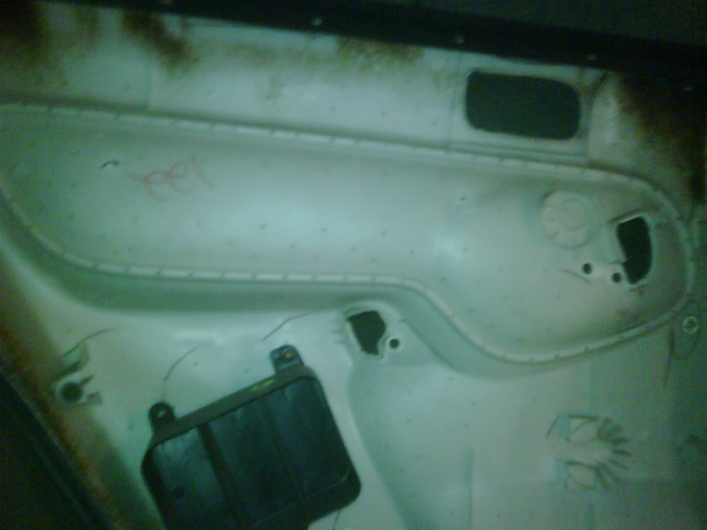

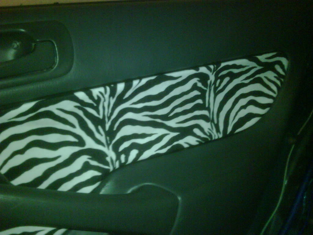

Here are some pics. I didn't attempt a DIY, but this is a very doable project.

Very nicely done!
