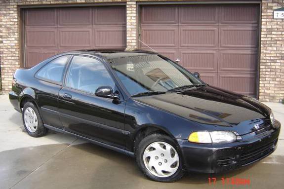

I'm diggin' the painted motor, bro.... btw, here's what the car should look like (suspension-wise)... this is my car back when all it had was an intake:
if you need more pics of anything, let me know and I'll see what I can dig up.
