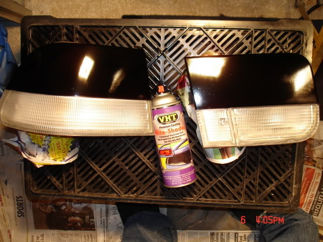

fist some 99-00 civic tailights with the oem clear lower portion and upper red.. BUT LET ME WARN YOU.. if cops are being that harsh on you already DONT DO IT! cause they can still get you for not having reflectors then.... and if youve gotten two tickets for some lame clear turn signals.... THIER TARGETING YOU HARDCORE!!!!!!
but if ya do choice to try it... first get some 2,000 grit sandpaper..... then sand off the raised lettering off the tailights... then once they are smooth then use some NIGHTSHADES tint paint and start painting them... depending on how many coats you do is how dark they are...
http://s40.photobucket.com/albums/e2...nting%20tails/
go thier for all my tint pics...
AND ALSO IF YA DO TINT EM THEY WILL ALSO HURASE YOU ABOUT NOT BEING ABLE TO SEE THEM DURING THE DAY...
but at night thier shouldnt be any problem besides the reflectors....
